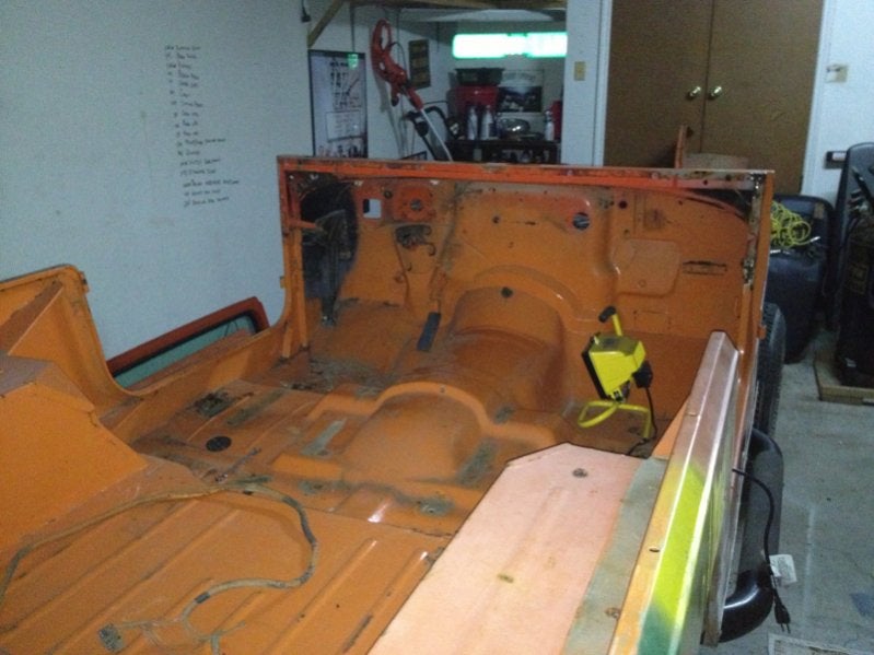

Down to just a tub.
Got 3 bolts out with no issues, the other 5 body mounts needed to be cut off... Started to take the body off... Realized there are 10 mounts total. Too late to get at the two by the gas tank.
There is always tomorrow.

It's been 1 week since I started and this is where I'm at.
A bit of rust, but not uncontrollable.
Garage is starting to fill up.
Some bad seals, but it'll be easy to get to now.
-Dave
