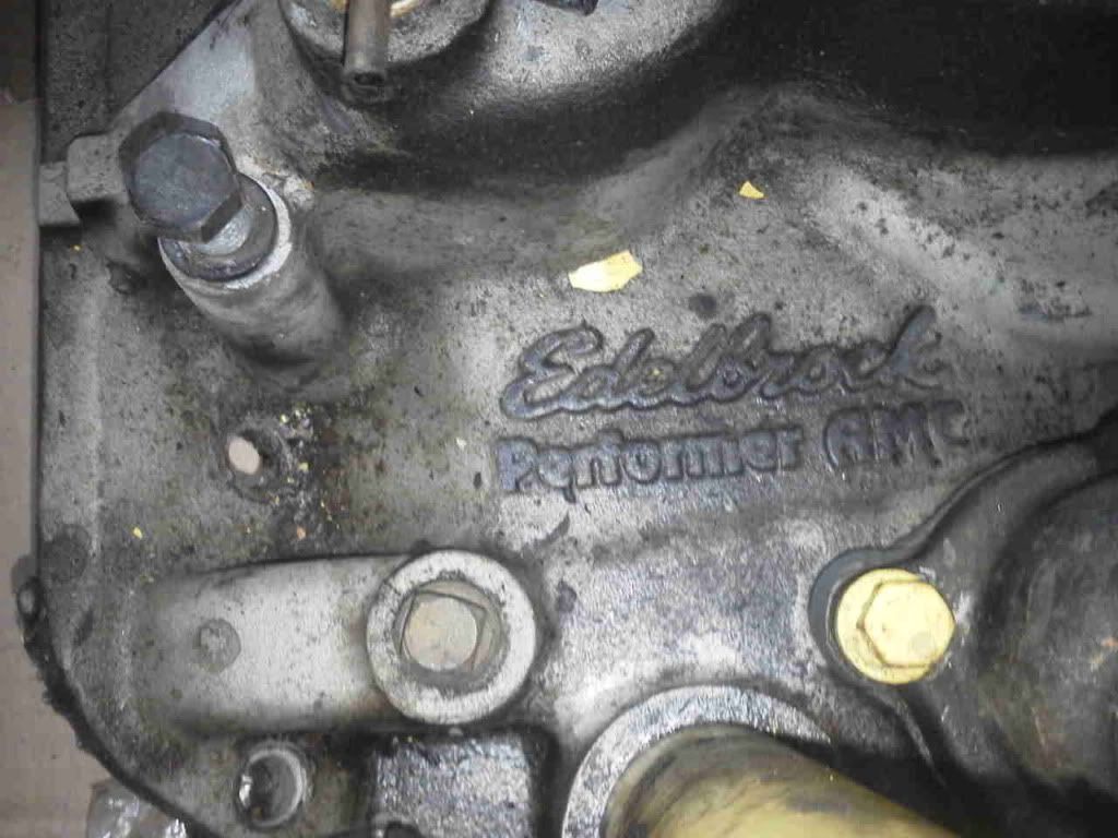

Good afternoon, guys.
The clutter was starting to get to me, so I spent the morning cleaning and organizing parts into boxes. Once that chore was done, I made a little more progress on the disassembly of the Greasy Pig.
I removed the timing chain and sprockets, valve covers and intake manifold. On the bright side, the chain, sprockets, dizzy drive gear, and fuel pump eccentric all appear to have very little wear, at least to my novice eye. How do they look to you?
The intake manifold is still quite a mess, so it's difficult to tell what kinda shape it's in. Any tips on quick and inexpensive ways to clean this thing?
I've also removed the rocker arms and bridges, carefully placing each set in labeled zip-locks per cylinder. Why does my manual stress installing these parts back to the same locations? They all appear exactly the same. Do they wear differently, or something?
Lastly, my manual says to use compressed air thru a spark plug hole to remove the valve springs. I'm not sure what this step does, or if it's necessary. If so, it means another trip to town for the proper pneumatic fitting...ugh. Is there another way?

as far as cleaning the intake manifold goes, mine was pretty bad but not quite as bad as yours, i started with parts degreaser to get the big clumpls off and then go over with this stuff called Eagle 1 Aluminum Mag Cleaner, you gotta use the kind that says NOT FOR CLEARCOATED MAGS its wayyy more potent then the regular, just follow the directions on the back of the bottle and viola, hope this helps
here is a before and after of mine
