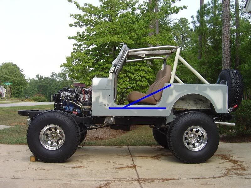

Deff gotta be able to get in and out. As high as mine sits, the only impact I'm concerned with would be roll over. I don't need a high bar. This is my plan:
Thread Links:

That would be cool, maybe 45 degrees was a little steep. I'll mess around with it tomorrow. How tall is your jeep anyways? It looks taller than mine but we have about the same setup. 4" + 1" + .5" = 5.5"
