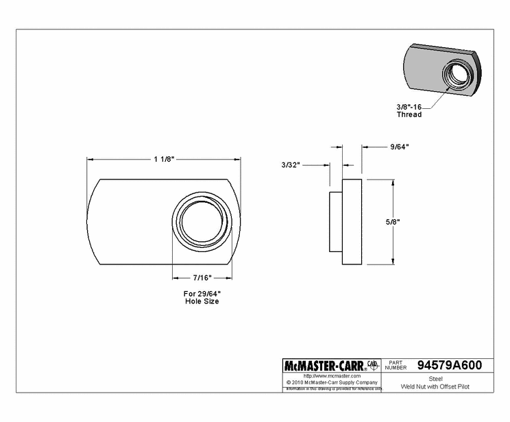

Not to drag up an old thread, but has anyone ever welded a nut with an integrated washer to the back of their dash for the hold down? I'm in the unique place of having a 75 CJ5 dash and a CJ7 tub. It looks like somebody had a later model windshield on it. But I got it sans the windshield.

I used Weld Nuts with the offset base and pilot, just like OEM Jeep used. They are easy to install with a portable spot welder or TIG.

^^^^ x2 what Keith said. I used those a lot on my YJ tub and they are quick and easy to weld in place.
