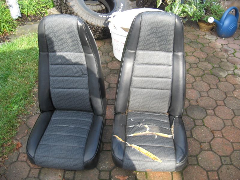

I have a good pair of black vinyl Jeep seats from a late 80s YJ. They are in decent shape, couple rips on driver's side, just need a llittle cleaning up. I may be willing to do a trade for some simialr seats in tan, beige or spice color. PM me for pics if anyone is interested, thanks.
Here they are:
