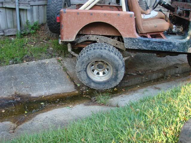

I have a Rough Country 2.5 inch lift on my 77 CJ5. The tires you see are 31's. based on the photo, would I be able to run 33's. it would only be an inch taller into the wheel wells. Most of my off reading will be seeking out fishing holes that few go to. That said who knows what the terrain will be like.

They might rub on the back edge of the rear fenderwell openings. Mine did with 2.5" of lift and 33s.

33"s will likely rub, as CSP said.
Here is mine with a 2.5 lift and 32"/11.50s. BFG ATs actually measure about an inch smaller than the advertised size when brand new.
As you can see, they only clear by about 3/4".

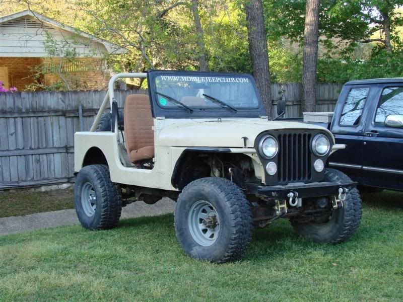

No rub on mine but I have a 1/2 inch of shackle and pretty beefy BDS springs.

I'm thinking of adding a 1/2 shackle lift as well. I suppose I could do that after the tires if needed. Are those Super Swamper LTB's on the blue CJ5?

Nah they're just old regular tsls, with boggers out back.
Im keeping a eye out for 34" LTBs though Im positive they will fit. If I dont find any Im just gonna spring over and get 35s.

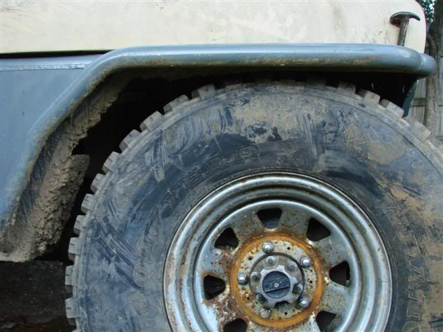

33x12.5 15 on wagon spoke. I did 3 .5 inch springs and .5 shackle, with tube fenders up front, it JUST cleared. In the rear, It just touched the bottom rear fender. To me, it looks like you need more lift for 33s.
