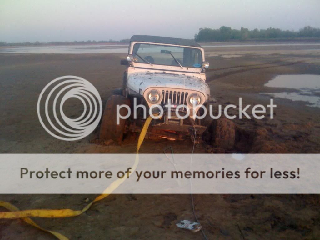

69" you can tell a big differance just by looking at it
wide trac (stock for '82)
full widths
