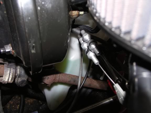

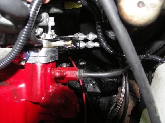

Here are my pics. Don't know how much good they will do you. It's hard to get a good shot with that MC in the way. My setup has two cables on it because of the transmission (automatic) kickdown!
