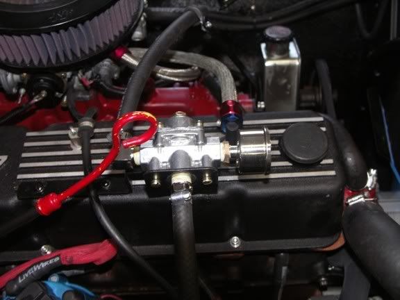

My aluminum valve cover has some unused threaded holes so I put them to use.

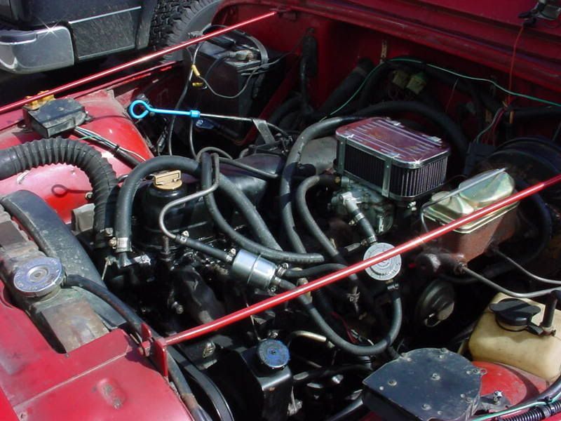

as close to the weber as possible, after the filter, and after the split for the return line
What kinda gauge is that? Where did you get it?
I've got a clifford cover on mine, but have the air cleaner for PB, so have to look and see what I have to work with. Raining here since my regulator came in so I haven't had a chance to look at it yet.
85 CJ7 258, borla header, Team Rush, MC2100 ,optima batt, Warn 8274, agr super box 2 & pump, T5 w/ B&M shifter, centerforce 2, superior 1 piece axles, warn hubs 2.5 in lift, 31" BFG MT
85 CJ7 258, A/C, T176, MC2100, Team Rush, Warn XD8000i, superwinch hubs, 3in lift 31" BFG AT/KO
Hoss
Is yours mounted or did you just hang it in the fuel line? It's not heavy. I wondered if I couldn't just let it hang.
I let it hang- it barely moved with that short of a line, I didn't see the harm.
I suppose eventually, it would be slightly more prone to cracking the hose, but I didn't see it as significant risk.

The gauge you can get from Summit. Mine is set up like CJ Chets!
