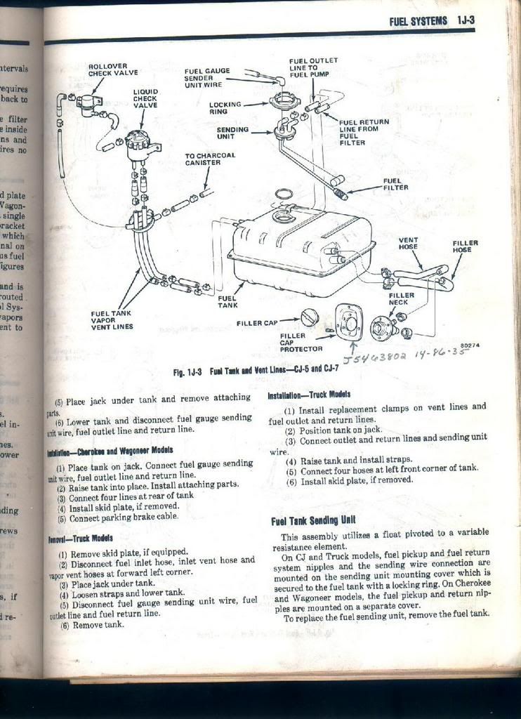

and for reference here's a pic:

Thanks for the quick responses. Unfortunately this diagram looks different than my tank. I have a 20 gallon tank and each of these two canisters are identical and drop into two holes that are in the top of the tank. Each has a hose attached to it. The canister is about 1.5" tall by 1" diameter and has the nozzle at the top with a rubber gasket around the top perimeter which mounts it to the tank. Unfortunately I broke one of the nozzles taking it out which is why I'm trying to find another. I'm wondering if I can get away with plugging it or somehow hacking it back together. If anyone has any of these laying around, let me know! Hope I don't have to buy a new tank!
