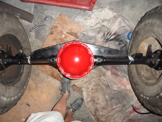

BESRK did this one for me.
He's about 5 1/2 hours from you in Newport News, VA.

I know this is an old thread, but do you have any other pics of this? How has it worked for you? It looks as though it's only welded to the center section on top and is made from 1" square tube. Can you give a few details?
This was Eddie's (BESRK) prototype. I think he still makes a truss but it's a completely different design.
That's very nicely done and solid looking.
