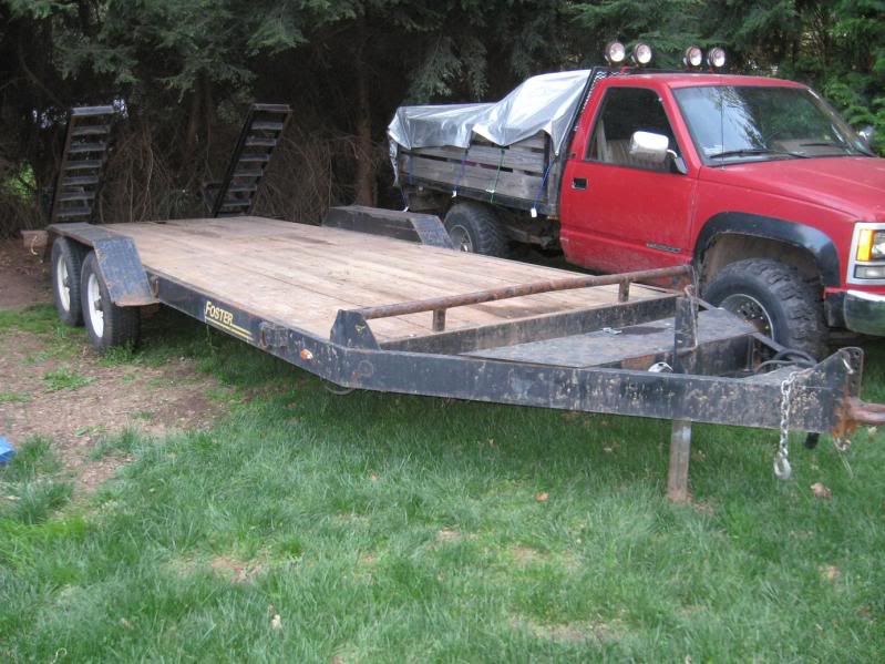

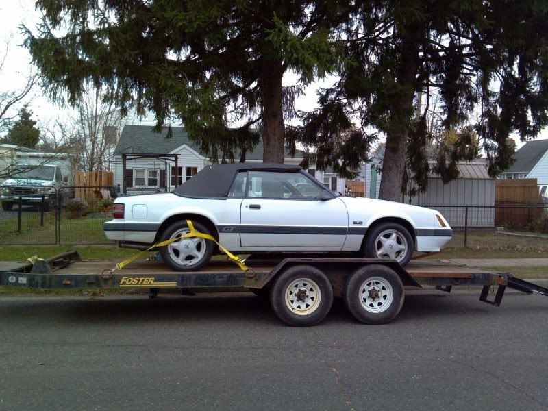

I use a Foster 18' deck equipment trailer. Guy I got it from said it was a 5 ton trailer.
Needs some paint but we use it to pick up all kinds of stuff

5 ton trailer would have 8 lug axles. Check the data plate on the tongue for the rated weight.

I don't agree with this. My enclosed 24' toy hauler/cargo trailer has 2, 5000# axles, they are 6 lug. For a GVW of 10,000 #'s , or 5 tons.

I believe most 7k axles are 8 lug. Believe it or not my 6k axles are 5x5.5 lug, same as a CJ

The trailer I borrow all the time to move my junk around has a 5 ton rating, but has 8 lug axles. This may vary per manufacturer.

These are leaf sprung. It rides nice. We added shocks to the axles to control "bounce".

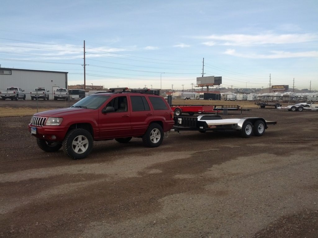

I just bought a 16 foot Finish Line Elite with fancy LED lights last wednesday. Used it for the first time yesterday. Pulls great. 3500# axles, brakes on all wheels. I need to get a weight distribution hitch though. I cannot yet afford a dedicated tow rig.
I also bought the Macs Tie Downs Ultra kit in black. Makes tying down SOOOO much easier. Got the chain hook extensions, and loops right into my stake pockets.
