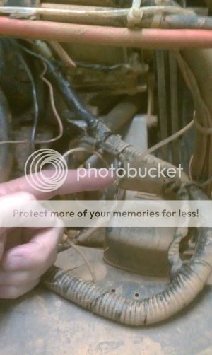

I am trying to clean up the wiring on a 76 CJ7 all these connectors are on the passenger side front of the block. I am sure they were from a wiring kit from the past, just need to identify them so I know what I do and dont need.
Thanks for any help you can give me.

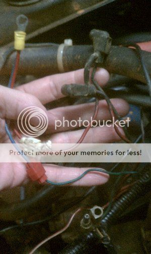

In your last picture those two black rubberish connectors go to the small terminals on the starter solenoid.

SO why on earth would the PO not have done that? Thanks for the info - gets me in the right direction.
ANy idea on the others?
The big grey rubber block in photo 1 I have no idea what that is.
Looks like 4 terminals inside it.
