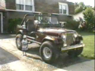

Are you absitively, posolutely certain of that? Highly doubtful that a true 35" tire like a Swamper would fit on your Jeep like that with only 1" of shackle lift in the front & 2" of shackle lift in the rear. This is mine briefly with 3" of lift and 35" BFG AT's (measure closer to 33") while I was waiting for my 32's to come in:
Looks like it was sitting about the same as yours is.
Back to stock, 31's fit reasonably well and 32's work OK on the street. Removing the front lift shackles would help put your caster back to spec and help steering issues...obviously you need to check alignment and check for worn/loose parts too.
