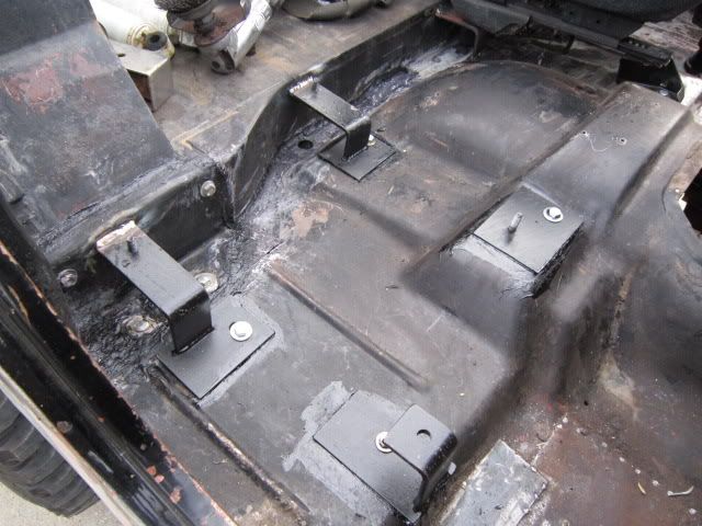

I went to the local junkyard and pulled seats from a 98 Grand Cherokee. I used some angle iron to make two bolt holes. Two of the bolt holes lined up exactly with the risers. Check my build in my sig to give you an idea of how I managed this. I also got the seatbelts from the same vehicle.

I picked up some seats from a 90's Cavalier.
I did the notch in the fender well
mounts
