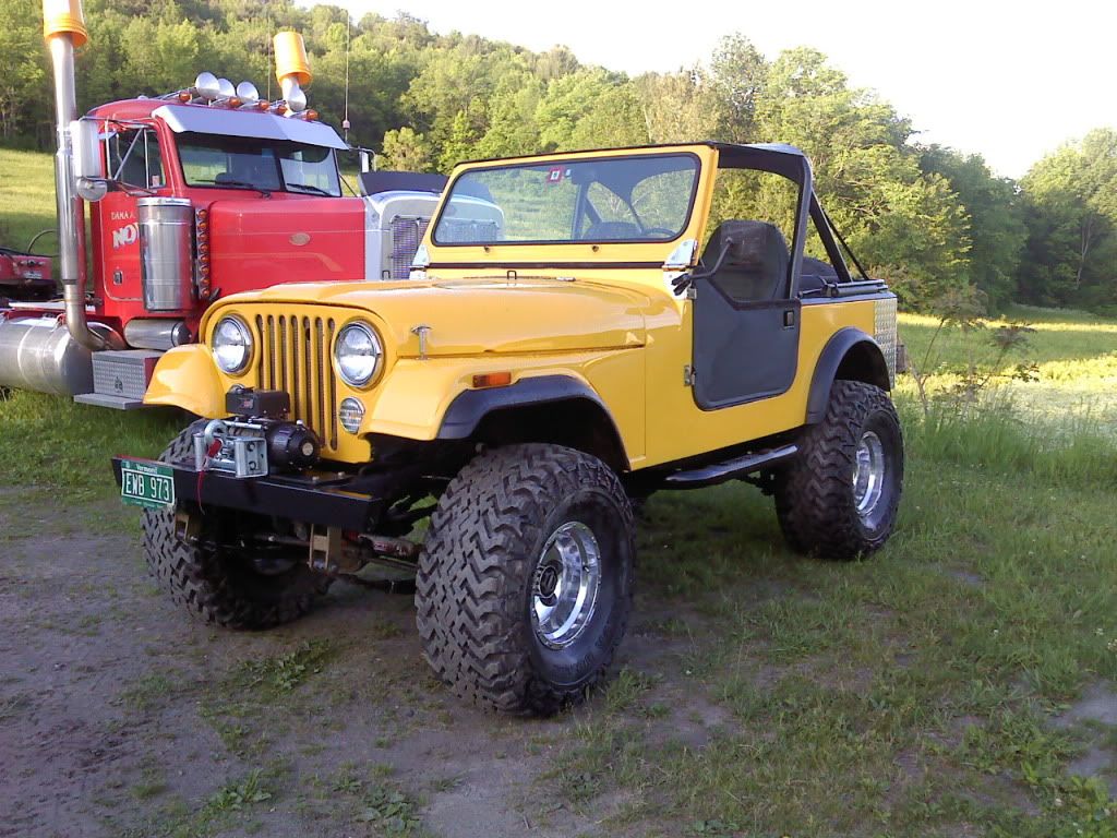

This was a 4" lift and 1.5" body with 1 1/8 lift shackles and 36's
But I will say now being SOA I would never go back to SUA

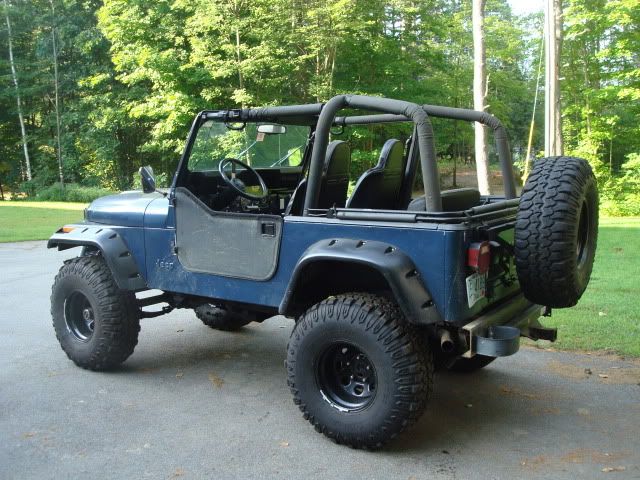

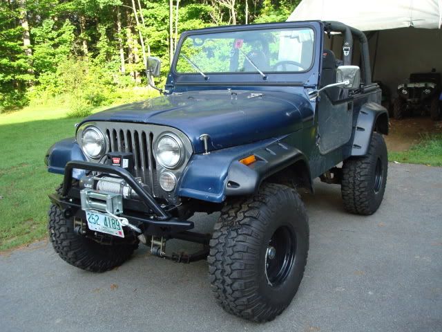

35's on a 4" BDS lift with bushwacker flares.
SOLD! 83 CJ-7. TBI Small Block Chevy 350/TH350/D300, Scout II Dana 44 front, CJ Dana 44 rear. 4" BDS Lift with 35's. Currently Jeepless.
