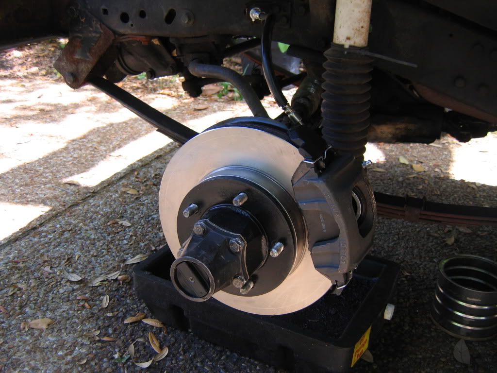

This is my first CJ so most of this is new to me. I don't always know how things are supposed to look. Here is a pic that shows another angle. I just got done doing the wheel bearings and brakes at the time.
After looking at some other pics online I now can see how mine is different. Looks like we have some work ahead of us.

Somebody explain what I'm llooking at in the first pic. Is the frame bent down?
This is the po's home brew srs.
It is highly dangerous, and I would not recommend it be driven on the streets.
Great looking job you did on the front brakes.
If you can tell us how you plan to use it, and what other modification plans you have in mind, we could give some advise on what is usually the best way to reconfigure it.
