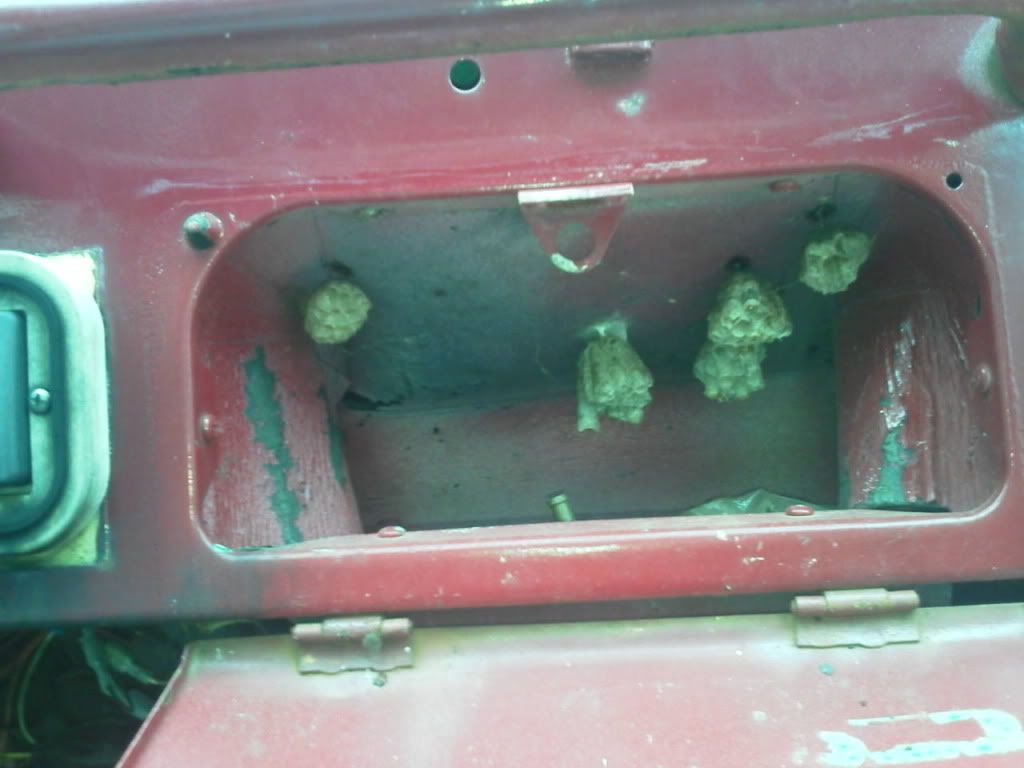

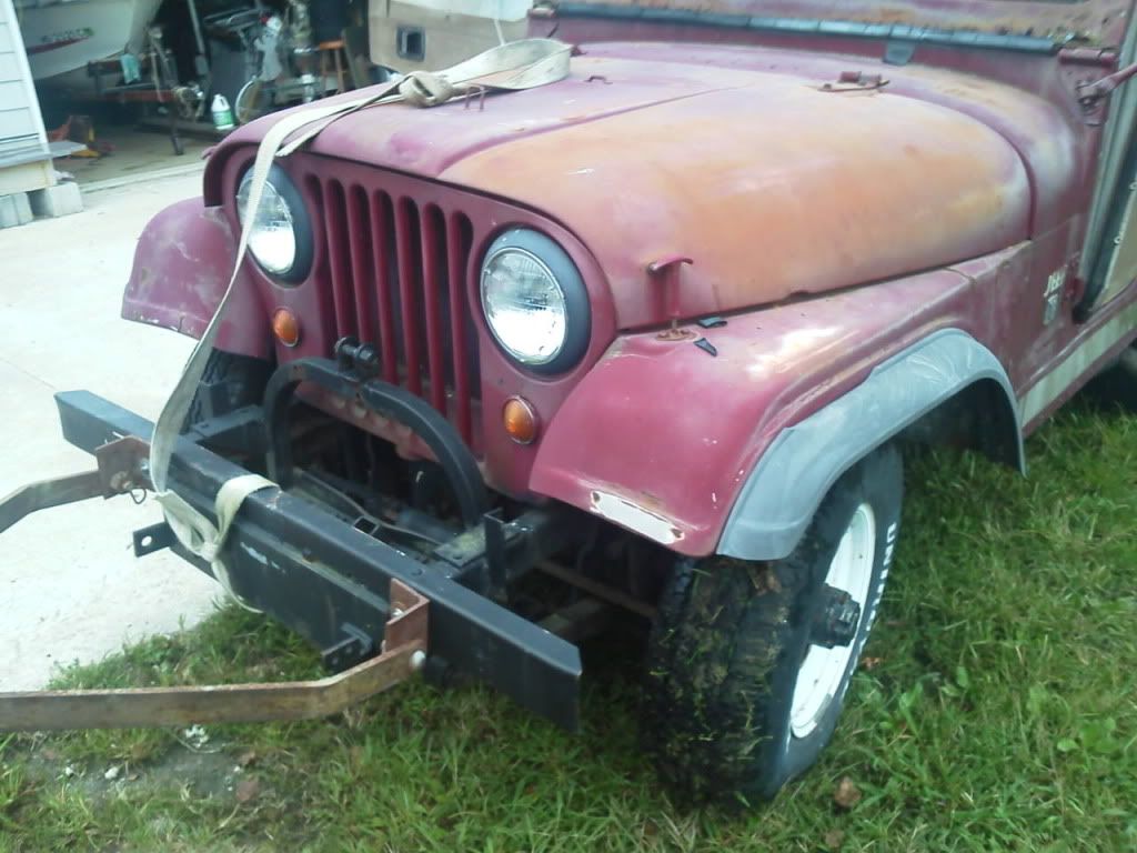

ok guys i have a yj, but my little brother just bougth a 67' cj wit the dauntless v6 for 150 bucks, shes got some rust and is gonna need new paint some new floorboards but the price was right and hopefully we can get it runnin for my little brother , tell me what ya think , the running gear is good the body is rough, the frame is pretty solid, im definetly gonna be sandblastin but hopefully i can get this thing on the road for my brother

picked it up today heres some pics , shes got long tube headers,

New cap, rotor, plugs, points, and condenser. Be sure to recheck the timing when your done setting the dwell. A great upgrade is an HEI ignition from a 76 Apollo with the 231 ODDFIRE. Speaking of the oddfire, do some research on the engine, as it has some ignition quirks you should be aware of.
Your CJ has an alternator upgrade. That is a good thing, however, I would dump the cheesy air cleaner for a larger, fully enclosed unit.
Most of this can be done with the body removed for easier access, however, I would solve any steering issues before pulling it.
It is a 12 volt system. Your currently running a delco internally regulated alternator, which isn't stock. It is however, a cheaper, and in my opinion, better replacement.
Back to your timing, Insure your rotor is under the #1 tower on the cap. While it will run if it isn't, it won't be right and you can have some frustrating times trying to sort out weak cylinders and misses.
