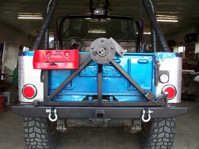

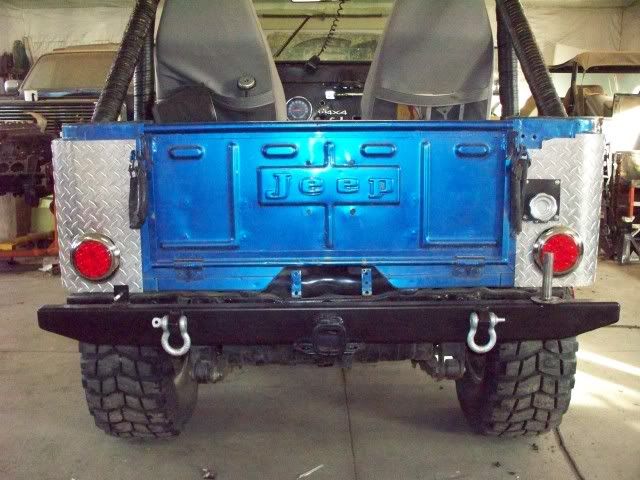

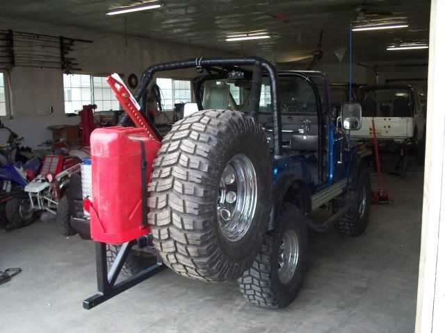

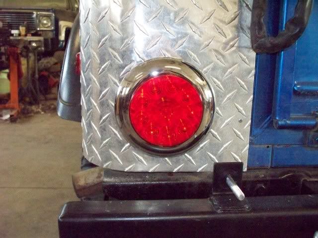

Finally mounted the new swing away spare bumper I built, and put on some LED tail lights...Now on to the hard top..

I wouldn't mind seeing a picture or two of your bumper and tail lights, ragsdale. I'll be having to do something similar with mine pretty soon and am always interested in seeing what others have done.

I copied BESRK's bumper style..

I built a similar bumper for my '7 and am looking to build a spare tire carrier. Just a few questions about yours...What did you use for a pivot point? It looks likes some type of spindle, but what exactly is it? And I assume the catch is on the bumper...Is it just one of those spring loaded pivot pins like trailer tailgates have?
Sorry for all the questions, just trying to get some ideas.

Jp360. the pivot point is just a solid piece of 1 inch bar. I had a guy at a machine shop make that and the 1/4" sleeve that slides over it. Its a really tight fit...than drilled a hole in the side of the sleeve and welded a nut and threaded in a grease zerk. and left enough of the bar sticking past the sleeve to put a locking collar to hold it down. If you do it that way the sleeve may need to be re sized after welding...but if you really want some good ideas check out this thread...its where I robbed all of mine
http://www.jeepforum.com/forum/f37/rear-bumper-w-swingout-tire-carrier-follow-along-101332/
