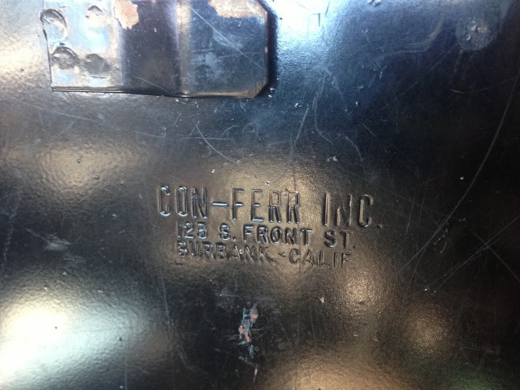

Those steps are in great shape. My originals became mangled as all heck from wheeling and took them off in the early 90's. Now I have a replacement set I bought from a forum member a few years back that lived in rust free zone of Texas.Got my side steps today. These are in great shape with absolutely no rust. I'll clean them up, shoot them with body color and get some new treads on them. Must be great being a Jeep fan out West!
Keith,keith460 said:Those steps are in great shape. My originals became mangled as all heck from wheeling and took them off in the early 90's. Now I have a replacement set I bought from a forum member a few years back that lived in rust free zone of Texas. I know they make new 3M treads that can be bought but I made my own based on exact dimensions of originals. I can scan the measurements if you like. http://s123.photobucket.com/user/keith460/media/84 Jeep Project/IMG_0015.jpg.html
Yes, a scan of the measurements would be great! I've already got the step locations based on another one of your posts. I'm thinking I can get the material I need from a skateboard shop. When you bolted yours on, did you need to reinforce the sheet metal at all on your replitub?Those steps are in great shape. My originals became mangled as all heck from wheeling and took them off in the early 90's. Now I have a replacement set I bought from a forum member a few years back that lived in rust free zone of Texas.
