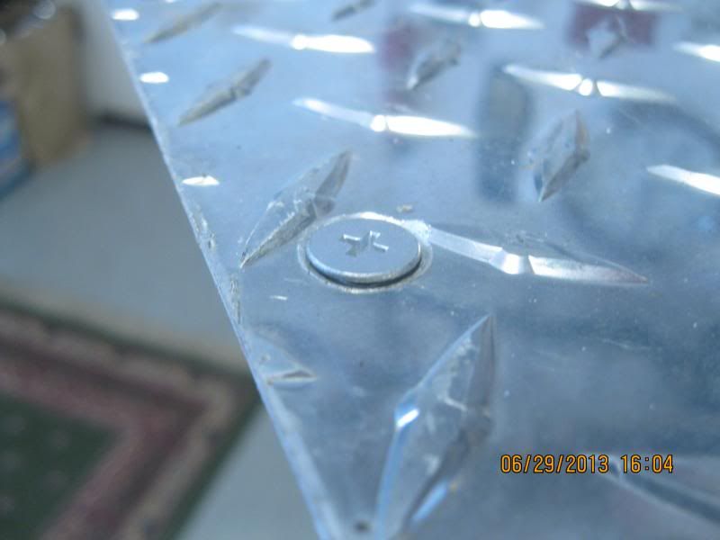

fuel pump access panel
after 2x having to drop tank (33 gal Aero monster) to service the in tank pump, "F" that. Made an access hatch. Measured while tank was out, plasma torch then a piece of diamond plate with counter sunk holes/self tapper screws. Then seal up with silicone.
virgin tub
we got a hole!
plate detail-- best part is I used material on hand
finished product and new tank lifted into position
ready to screw down.

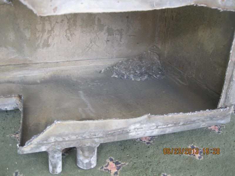

out of curosity cut open old tank and no wonder the pump failed. look at all the krap inside. the interior lining failed and = nasty pump killing debris.
filter was completely clogged too.
edit: to be fair some of that is plasma blow-thru, but before i cut it open there was a LOT of debris.
