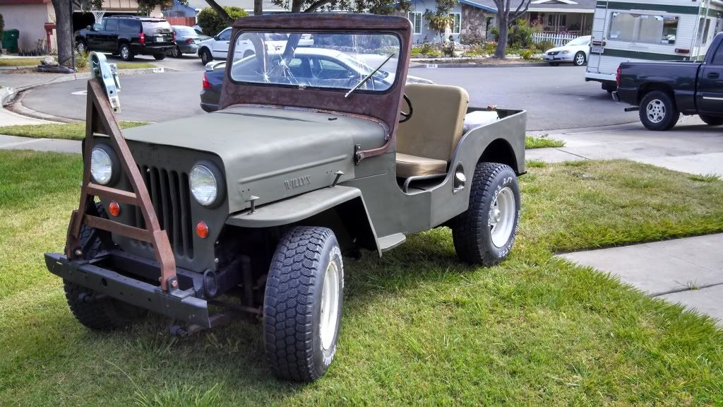

put the taillights on my 54 and did some engine work for the cooling system and painted the air filter housing. and drove it around the neighborhood for fun. I put the hood on it for S's and giggles to see what it would look like today I will bolt it on.
