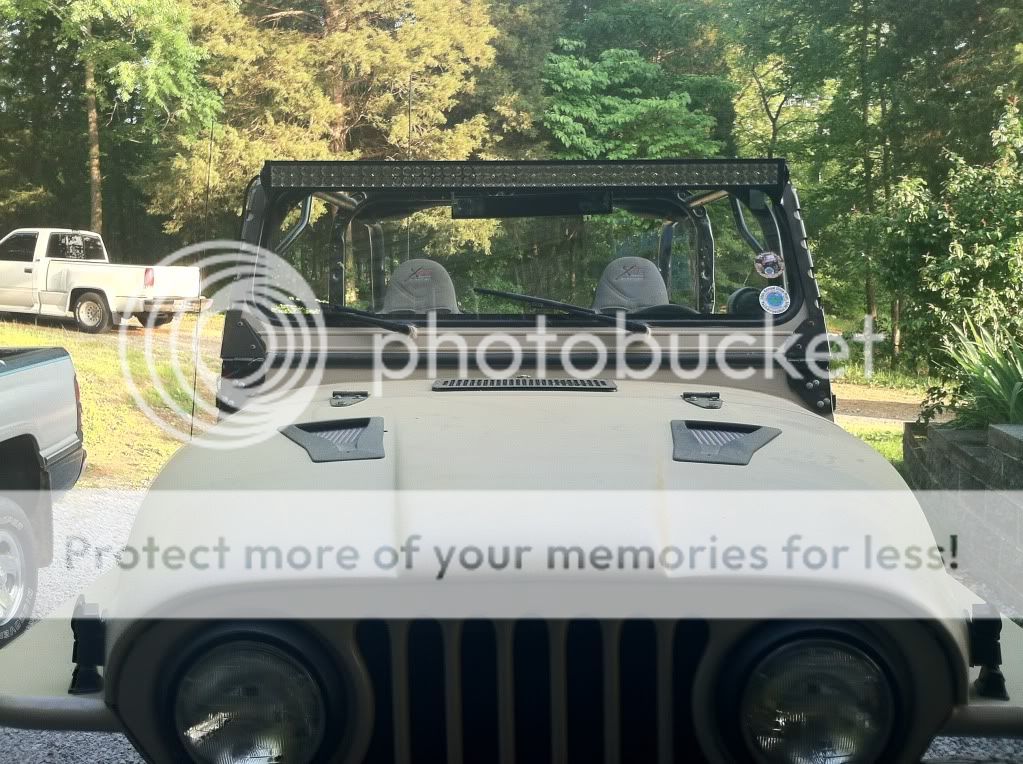

Installed my light bar
Nice! If I put that in my CJ it would probably double the value.
