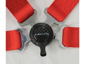

5 points are nice, but very rarely is there a situation where the anti-submarine belt (crotch strap) is useful. I would get a set of 3" wide belts. Anything narrower and you end up with nice bruises or cuts where the narrow belts pressed against you.
I stay away from cam lock belts. They tend to get gummed up with dirt etc. and I have seen them fail (not fully lock in). I only use latch lock belts. Very few moving parts, the locking mechanism can be seen clearly, and they are not affected by dirt.
Stay away from these.
These always work and are simple.
Thanks! I was actually going to go with the cam lock style but now ill just go with the other ones.
