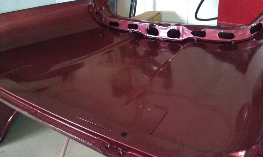

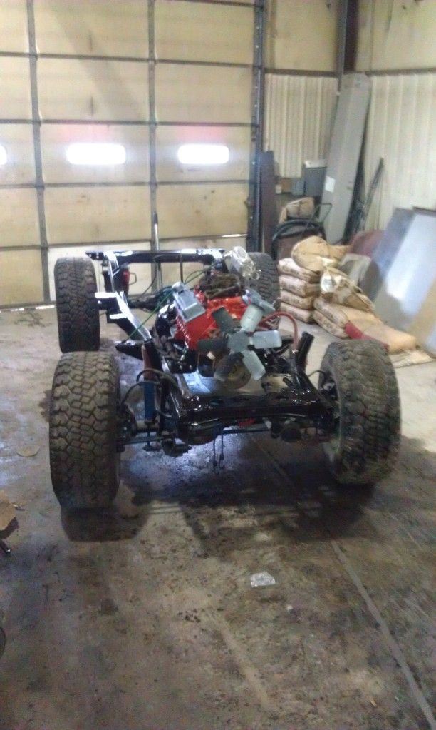

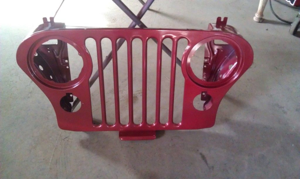

Ready for mating ( giggidy ) ...

Originally Posted by CherryCj7 View Post
Robrich, How many gallons of paint is required to paint your Jeep? I am going to be painting my Jeep this summer and I am thinking of jumping on that e-bay deal! Thanks! - Vince
Well 1 gallon should do it but at this price I'm thinking about ordering a little more for touch up just to have it, trust me, buy an extra pint of the wetlook hardener my painter says he is using a little more than the specs call for. I have to order it tonight. Be prepared to put like 2 to 3 coats on at a time as you have to spray it at almost 70 PSI because of the high metallic content he's already down to 1/3 of the pint and still has a half gallon of paint. Joe the painter says he has to dry dust it a few times before it wants to stick well. Sure am glad I'm using aguy who paints regularly because from what I see it takes a practiced hand and a working knowledge of paint application.
He told me today it may not be done til Wednesday as he has other jobs to do in the mean time. He still has to spray the windshield channel, half doors and the tub. I guess that buys me time to run the light blue aluminum fuel lines and the tranny cooler lines. I was putting them off to hurry for paint.
