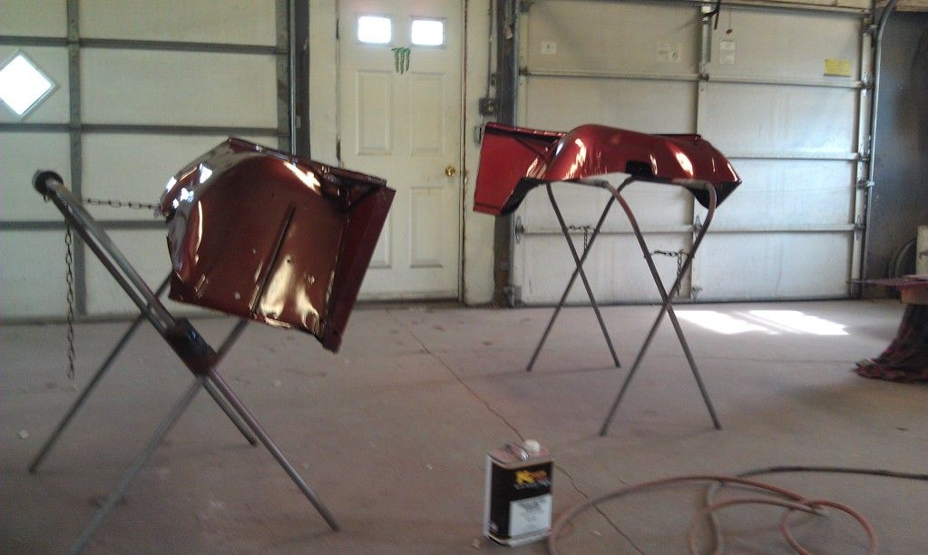

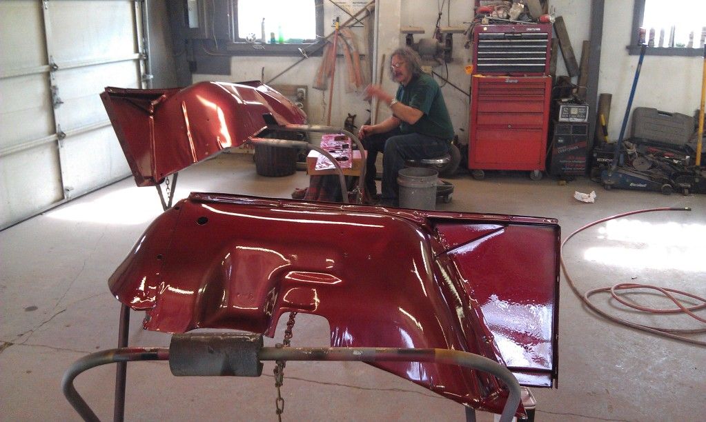

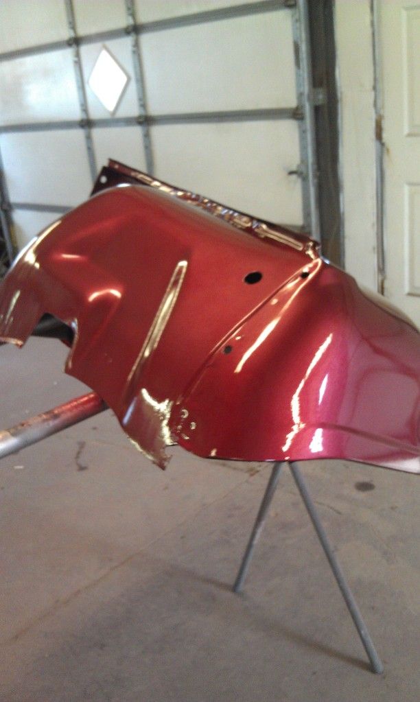

another peak ... the painter is getting busy, look at the one photo with both fenders believe it or not they ARE the some color, it's just the way the lighting effects the appearance....
**** CANDY APPLE RED METALIC ****

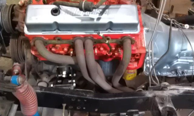

This evening I got all the Novak Conversion mounts welded or bolted down on the chevy 350 and 700r4 we swapped in yesterday. Tomorrow or Friday. the chassis mates up with the body for the final exterior paint work. Should be assembling everything starting around Monday. I still need to add and subtract 2 1/2 inches on the driveshafts but... It's come a long way since mid-November. ( Phew! )

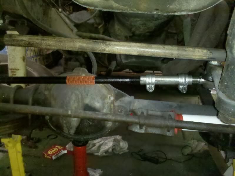

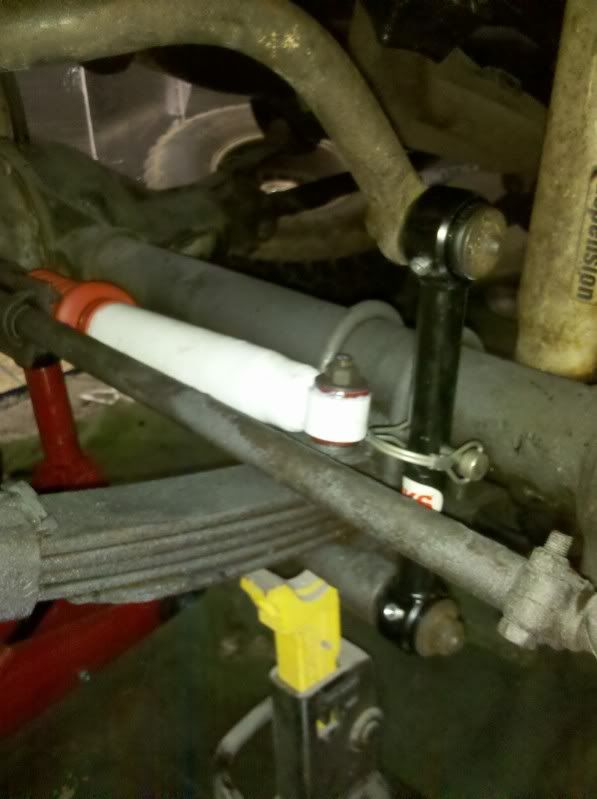

this past weekend was new rotors, pads and stainless lines, along with taking apart and cleaning the hubs. today was installing the junkyard swaybar with new bushings, new tie rod with home made flip, new steering stabilizer, and new sway bar quick disconnects
im going to make every effort to keep that orange net thing on there as long as possible.

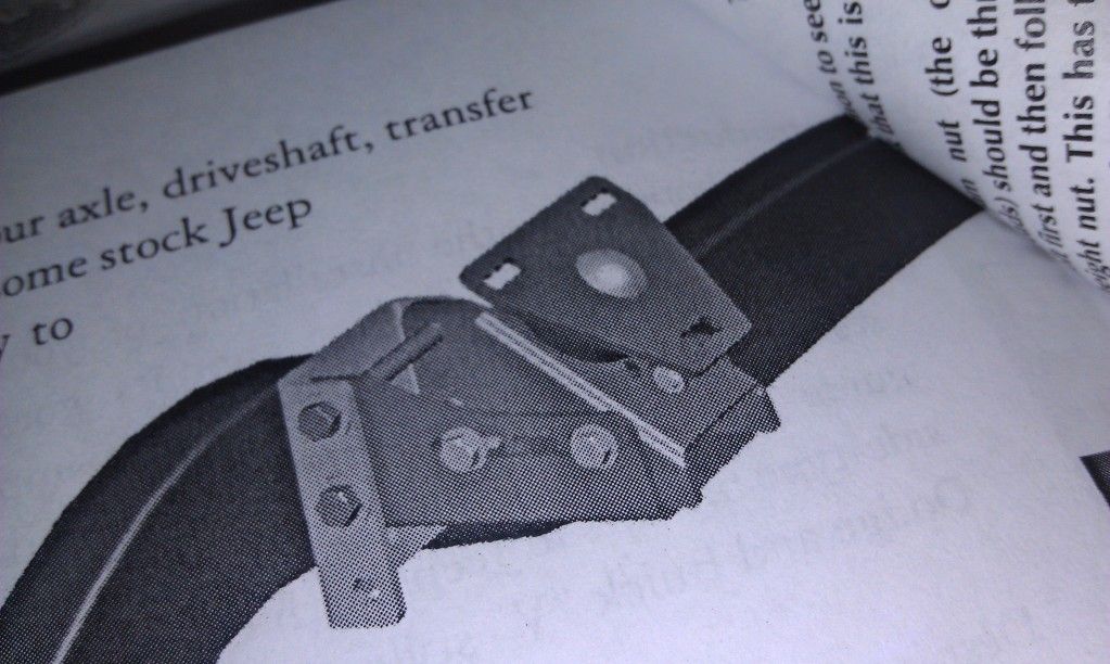

look at those $ 218.00 motor mounts from Novak Conversions... expensive yes but amazingly adjustable and IMO worth it. Those headers are out to, just to tight, new shortys will be here Friday.
Here is a drawing that shows how they work...

John87, That paint is an ebay special for $ 45.00 a gallon !! I can't believe how nice it's coming out. The paint is from a company called Trinity 1945 from Toms River, NJ They have a website also. The paint is called Starfire and it is an acrylic enamel single stage. They ( of course ) recommend their reducer and wet look hardener. The mix ratio is 8 parts paint to 2 parts reducer to 1 part hardener ( or 4-1-.5 ). I was afraid it may be to light but that fear is now laid to rest. It has to be sprayed at 50 to 60 PSI which the painter wasn't crazy about but there is alot of metallic in it, almost to much according to Joe the painter.
