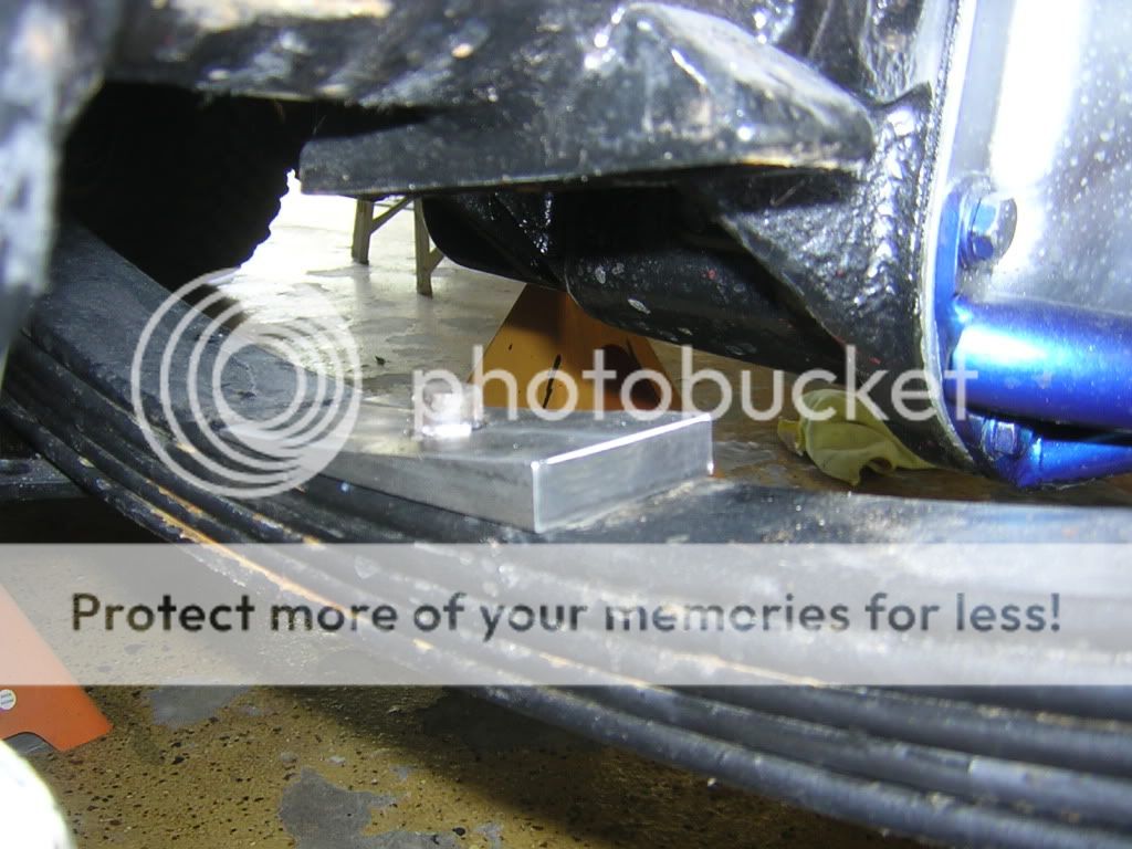

Install front axle degree shims to improve caster on 4" lift
Oh man, be careful with those aluminum shims. They will wallow out where the hole is and wear down. You should really use steel shims.
