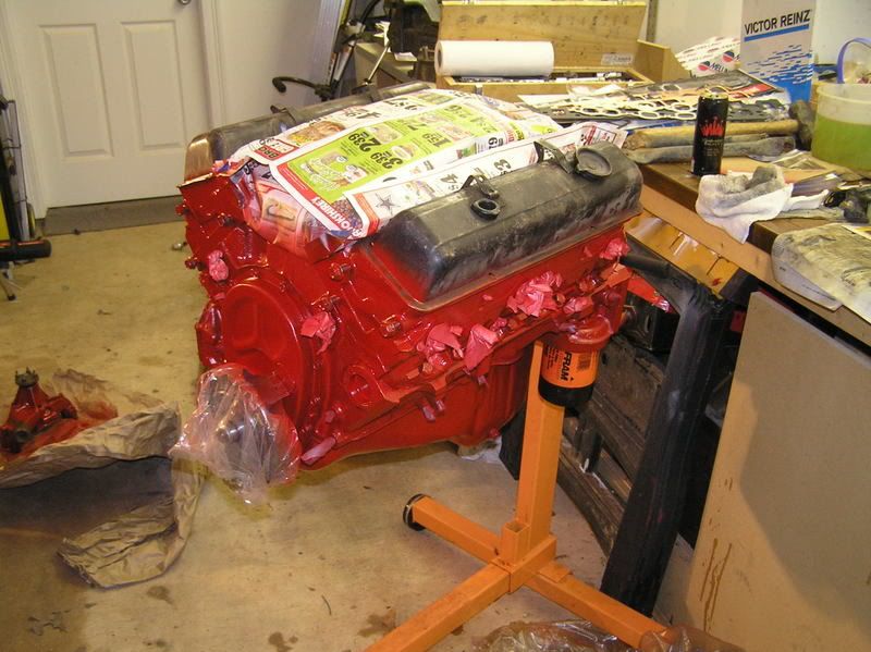

Put the last couple coats of paint on my 350. Removed the fenders, radiator, grill, and all the wires connected to my 360, getting ready to pull it.

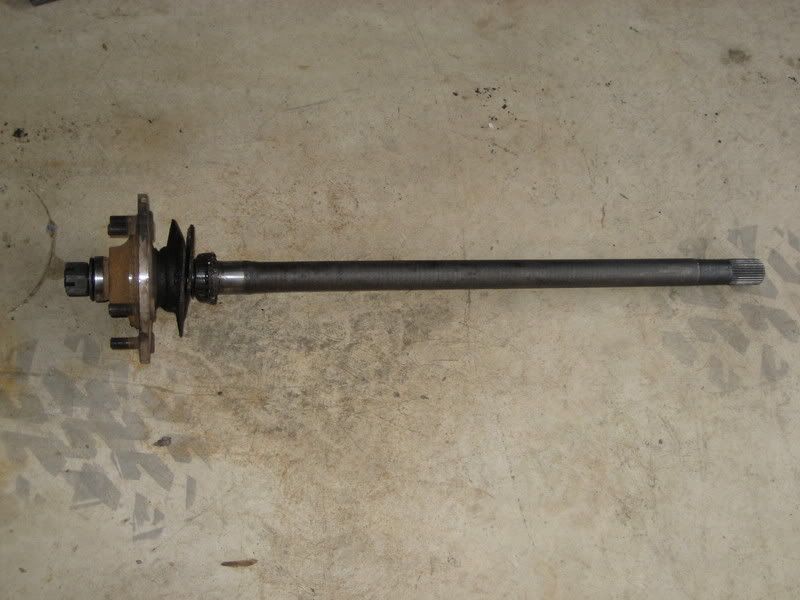

Starting at the beginning with the 2 piece axle replacement:
1. Top diff cover bolts gave me trouble. Recommend ratchet style wrench or crows foot.
2. Left axle nut would not budge. Soaked it overnight with PB blaser, heated up with propane torch, and fianally got it loose with a 4ft piece of steel pipe over the top of my wrench!
3. Step 2 was a waste of time since I later opted to pull the hub and axle out all at once. Used the Advance Auto parts axle and seal puller. Came in handy, especially for the seal removal.

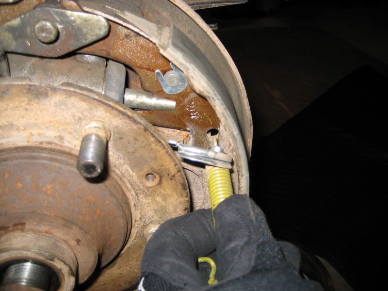

4. Tore apart the drum brakes and fought with the emergency brake cable. Next time, I'd leave the brakes intact and just remove remove the 4 flange bolts with an offset wrench to remove the axle. (It's all about having the right tools) Take the time to clean all of your parts.

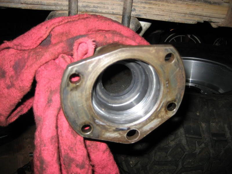

5. Decided to leave the hub intact since one was 21 years old. Had to get the backing plate off so I cut the bearing up with my cutoff tool then removed the backing plate.
6. Had to order two protective guards, think they were $5.95 a piece
6.1 Made a rookie mistake with the inner seals trying to figure which side faces towards the diff. Recommend the $8.00 seal installation tool at Harbor Freight to make sure the seals go in correctly - metal side of the seal facing the diff.
7. Also ordered new shims since the old ones were toast. Definately take your time here to measure how far the bearing extends from the housing. Measure twice...and plan accordingly. Cheap feeler gauge worked fine.
8. Assembly went pretty smooth. Went to an on base autoshop and used a bearing press for the first time - pretty cool. An absolute must to press the bearings and the retainer on the shaft.
9. 3rd trip to Hardware store, this time for new nuts, bolts, and RTV.

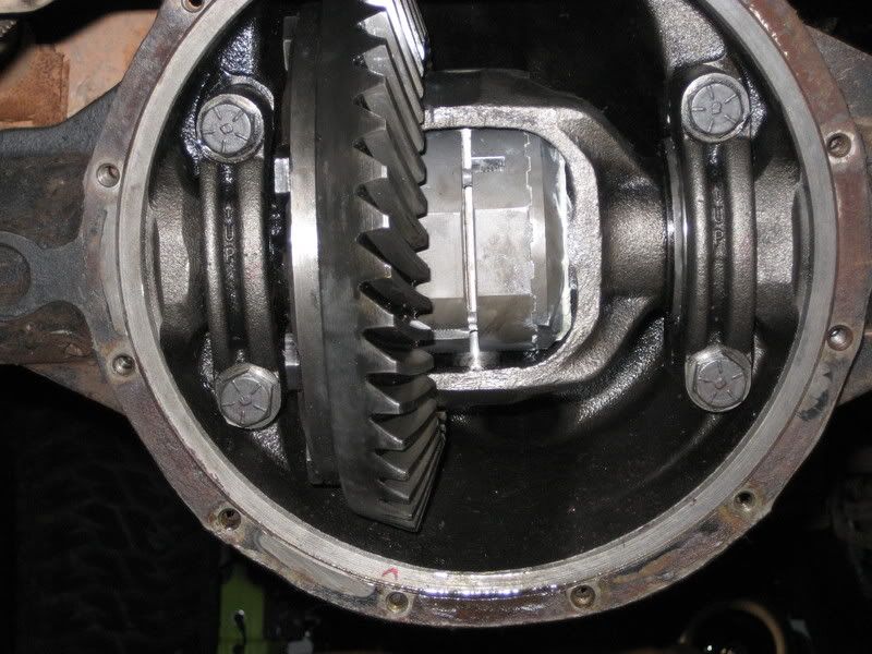

Aussie Install:
1. I went way overboard on the teardown. Marked all of the bearing races and ring location anticipating pulling out the diff. Only later to realize I should of left left the diff in. Struggled with the retaining pin and the center shaft. Pin finally came out with a tiny screwdriver and hammer. I then pounded the center pin way back into the pinion housing. Could't pull it the rest of the way out or push it back in. Stress level was high - time to pull out the diff.
2. Dropped the retaining bearings by removing the two bolts on each side...Removed the diff, even though I didn't need too. Rubber mallet helped to encourage it out! Pounded out the center pin and the spiders and side gears easily came out.
3. Directions ask to identify a thick ring gear or thin. Hellifino...Searched JF...no luck. Went to the shop, fastened the diff in a vice and remove the 8 bolts. Ring gear wouldn't budge. Marked the location and pounded with a rubber mallet, finally got the ring gear off.
4. Greased up the new aussie gears and installed them in the carrier and put the ring gear back on being carefull to use a "star" pattern while tightening the eight bolts. Never did see any thrust washers so I kept going only to find out the were sticking to the old side gears.
5. Other than fussing with the 4 small pins and and springs, putting the aussie in the carrier is very simple. Important step is to pull out the feeler gauge and measure the gaps. Aussie wants them written down in case of a warranty claim later.
6. Time to get the heavy diff back were it belongs. This was painfull since it was a very tight squeeze and the shims on each side didn't want to cooperate. Wish I had some sort ot brass shim installation tool to ease everyting back in. Tightened everything up using threadlocker then went to back to the axle shafts.
