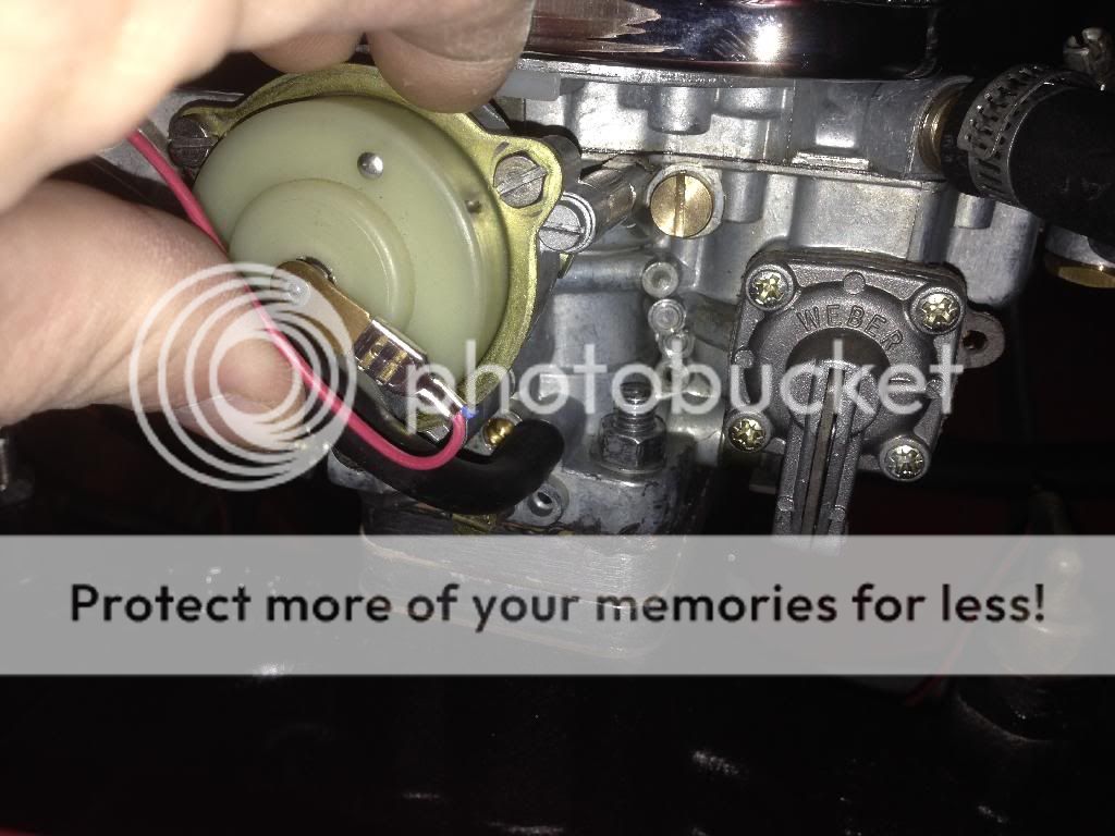

[QUOTE=supersport126;18514137]Ok someone please help me just a sec, I'm adjusting the choke today and noticed this unplugged hole!! Now, I've messed with this carb quite a bit over the last year, and never noticed the empty hole just below the "s" port. That leaves me to believe it prolly had a brass plug in there. swatson454"s pic above looks like it may be plugged? Please chime in and tell me if this hole should have a plug... Funny cause just noticed it and it's all the sudden running like ****
Supersport
Your hose is connected to the "S" ported vacuum source.
I have never seen a hole below that "S" port.
On some of the older "O.E." castings had a stud that went into that hole.
Does this hole suck, vacuum? All the time? Only on acceleration?
If not don't worry. If so, plug it with a lead shot gun pellet and a little gasket sealer?
Let us know what this might be.
UPTILLNOW
Post Script: Swanson has a 38-DGES and yours appears to be a 32/36 DGEV
If you have a 38-DGES this would be your mixture screw missing.

What!, no it's a 38 I swear I've never seen it before either! And I put this carb on, jetted it, tuned it, with some of your help I believe. The pic two posts earlier shows same hole I just recall seeing it before.

I think he means the hole next to the idle mixture.
If there's vacuum at the hole, either at idle or at higher RPMs, then plug it. If not, then don't worry about it.

You can always drive a piece of lead shot into the hole if you've determined that it's leaking. I'm thinking the tackle box might be a good place to look.
