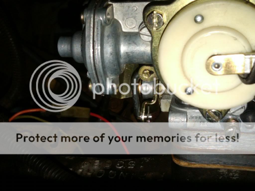

There's another adjustment you can do that makes a world of difference. At the back of the carb is a vacuum diaphragm with a little, brass, dust cap in it. If you can get the dust cap wiggled out, you can adjust the amount of pull-off the choke plate has with a little flat-head screwdriver. Set your pull-off there and use the other adjustment to set the time it take to fully open.
It's the pod-lookin' dude on the left. Just poke the dust cap back in when you're done.

Thanks guys, yes electric is working properly. I'll try the pull off. Basically I need the plates to be open more after starting. Runs and starts perfect but after 30 secs is starts to get ruff. If I then reach over and open choke plate it smooths out

Ok someone please help me just a sec, I'm adjusting the choke today and noticed this unplugged hole!! Now, I've messed with this carb quite a bit over the last year, and never noticed the empty hole just below the "s" port. That leaves me to believe it prolly had a brass plug in there. swatson454"s pic above looks like it may be plugged? Please chime in and tell me if this hole should have a plug... Funny cause just noticed it and it's all the sudden running like ****
