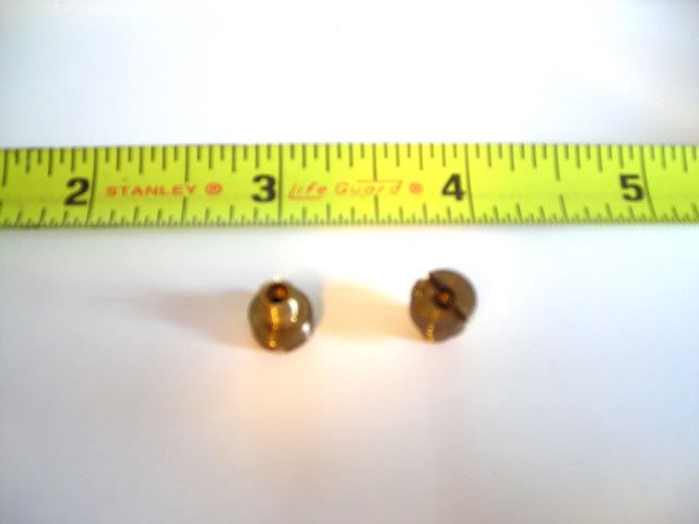

the run jets were both 135 from the factory, and the idles were both 55.
I changed out the idles, but i am having a hard time adjusting the idle, and af mixture. it is running a little better, but the idle seems to jump around while just sitting, making it hard to adjust. usually at about 800, then drops to 400/500 and can go up to 1200. Upon hard braking/ stopping it drops low and wants to stall w/o giving it a little gas. also it will stay around 1200-1500 after accelerating, and slowly drops back. any suggestions?

Are you saying the Run Jets below the float.... they came with 135 jets too small??? The Idles are on the outside 55, are to big. Please Confirm what jet came in your new carb??? And what did you change the Idles/Outside jets to. That large a idle jet means your idle screw is way in most likley. With the idle screw all the way in it opens the throttle plate and progession ports and will really mess stuff up. Your idle spring is a all compressed right??
If you got the extra jets put 147 run and 35 idle and readjust your idle it will most likely go up 500rpms or so with jet change and you willl need to back out the idle screw. Carefully lightly bottom your mixture screw and back out 1.25 to 1.5 turns and try that.

My carb came with run jets 135/135 and idle jets 55/55. I put in 35/35 idle jets.
I left the run jets as 135/135 and cannot put in a 147.5 run because i do not have one.
Also can u please label the idle, mixture, etc screws on one of the pictures. its hard to find a good pic, i just want to make sure im adjusting the correct screws in the correct order.
From what Weber told me the Idle jets supply about 15% of the run circuite.. So when we make the Idle jets smaller the Run jets need to get bigger. Do you have any other run jets?? With this combo 135 are too small.
We could also drill out the 135's if you have full selection of drill bits. The number are metric holes.
I typed wrong prior post its 147 not 147.5 for the run jet. corrected it above.
147/135 = 1.089 does not look like much but that is 9% more fuel
Originally Posted by Fjguercio View Post
If you got the extra jets put 147.5 run and 35 idle and readjust your idle it will most likely go up 500rpms or so with jet change and you willl need to back out the idle screw. Carefully lightly bottom your mixture screw and back out 1.25 to 1.5 turns and try that.

i do have the 140 i ordered, but i didnt think that this would affect the idle??
it seems to run fine in all of the gears, it is just when sitting at idle or slowing to idle that it runs erratic and wants to stall.

135 Run Jets are too small, in post I used 145(drilled) and 147. I would suggest 147 in both.
Once you get the correct jets or close, will need to go back adust your mix & idle, then ck the time,
You did not mention what happened to Idle when you putin the smaller idle jets.
Did you adjust your mix and idle after you put the smaller idle jets in?? Where are they set?
Take a look at the Spark Plug Reading Link and your plugs will be a little too lean.
return line on your fuel filter needs to be on top on exit, not bottom or side.
The labled jet picture was added above.

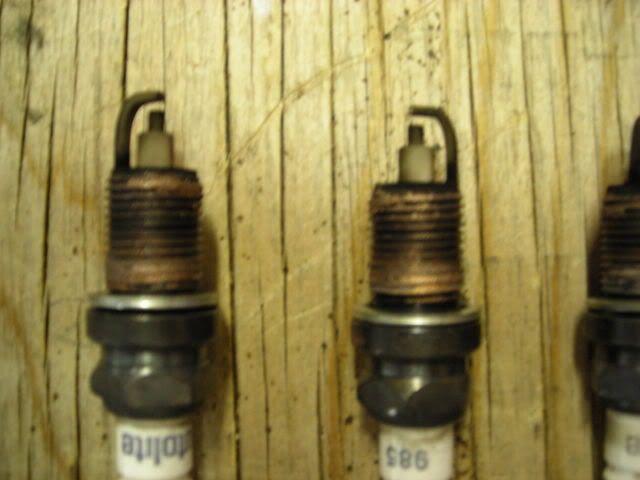

Here is picture of my hwy plugs. Hwy miles, shut off pull over. I want a little richer/more tan for hwy but they look pretty good.
