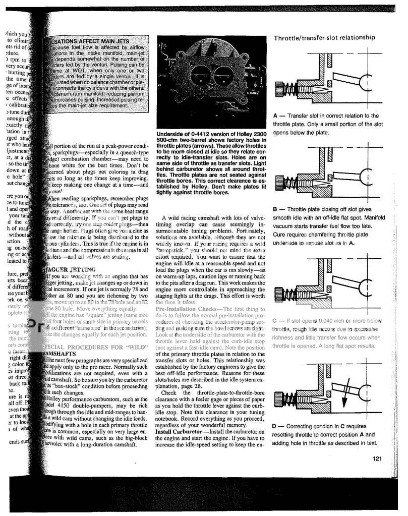

You must be speaking of the tiny little hole that should not exceed 1mm and be placed on the side of the throttle plate that is opposite the enrichment holes... the one that should be between 2-3mm inward from that edge. No Sir....not me.

Don't tell anyone you said what???
OK, it's a deal, I won't tell, but you don't tell them a little trick about drilling a wee little hole in the throttle plate that allows you to bump your idle up and still get normal progression....
All this fun you guys are having is making me want to put a Weber on mine.
Originally Posted by mcmud View Post
Oh, thats good....
Curious minds want to know.
Not that I would ever consider such a thing (insert Dr. Evil pinky finger here) but if I had a situation in which I had a carb with a single idle circuit, my idle air bleeds were known to be clean and clear, my idle jet size was known to be of adequate size, my initial advance was at a setting known to work and I was still not able to get enough volume of air to idle the engine without opening the throttle plates into the beginning of progression, I might reference these two pages. Hypothetically speaking, of course! Purely for entertainment purposes only...
Sorry for the poor quality. At least the cat didn't puke on this one, jeeze.
Shawn
