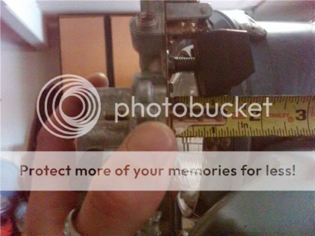

Here's another "what if":
The only time my 38 ever layed down on me was when I was doing some float setting tests and set it clear out to 7/8ths. Have you checked your float setting?
18mm if you have fancy shmancy tools or a smidge over 5/8ths if you're a barnyard bum like me when held vertically with the float resting on the needle.
