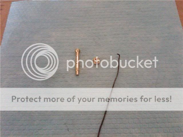

[/URL]
Water makes a pretty poor fluid medium but you get the idea.
What am I seeing here?
Just how it works. How the vacuum signal creates a depression in the emulsion well causing air to flow down through the tube and blow the fuel up into the booster. I'm pretty visual so I wanted to actually see it all happen.
