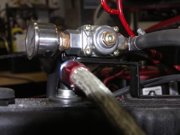

Here's how mine is setup:
I got the fittings at the local Autozone. I also use an electric fuel pump, but that's just me.

I mounted me here. I had to put some soft line from pump to fender mtded regulator. Others have posted to put hard fuel lines across the engine. This is clean and easy and will replace the fuel line when I replace fuel filter. My CJ is limited use 2-3k/y. I will put the carter pump below the gas tank and cap the mechanical pump port.

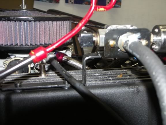

I have a fuel filter prior to the fuel pump also, so fuel thru new pump and FPR are filtered also.
The picture shows the fuel going to the Weber Carb Inlet, it ends there, there is now return line.
