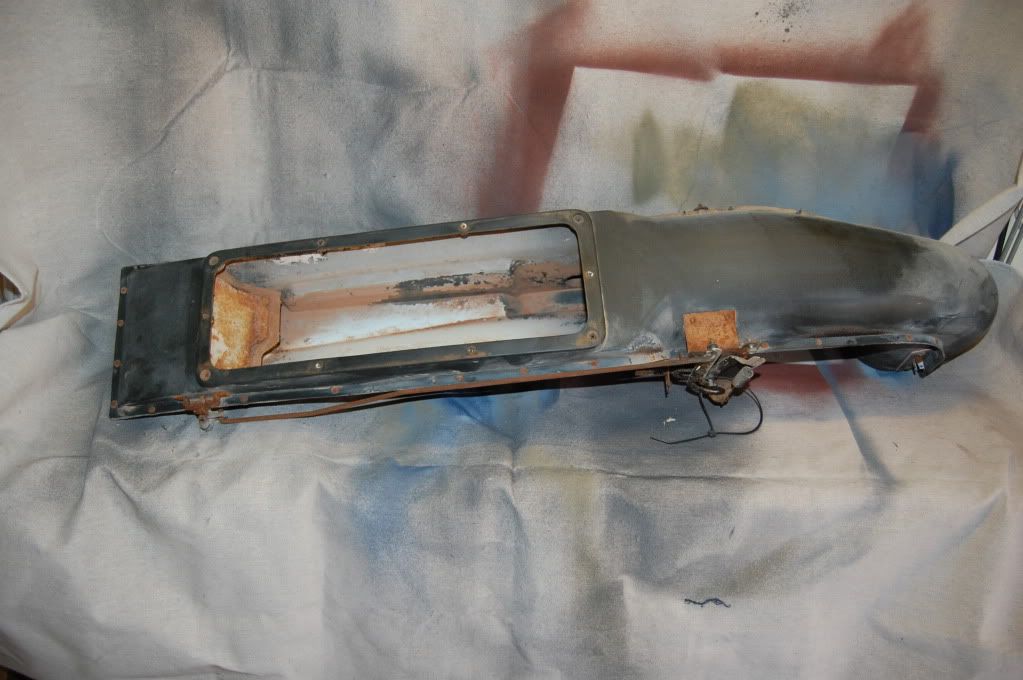

How about the fresh air vent on the driver side? Once those fail, might as well leave your top off in the rain.
You can see the rusty flap on the left side of the intake with the rubber seal..

Not sure if the 83 design is different than my 78, but the screw holes for the intake grill are inside of the fresh air box. Its design promotes draining of rainwater to one end and out the designated drain. However, there are small bosses on the underside of the cowl where each screw goes through. These bosses seem to go to the outside of the vent box. I could see that as a slight possibility for a water leak.
Therefore, I decided to try and seal mine. However, I took a different tact. Since the problem is at the screw holes, I put some silicone at each screw hole as well as on the 4 that hold the vent box up to the cowl. I also dabbed some silicone into the screw holes in the vent grill and buttoned it all up. I'll let you guys know how it works out at next rain event.
