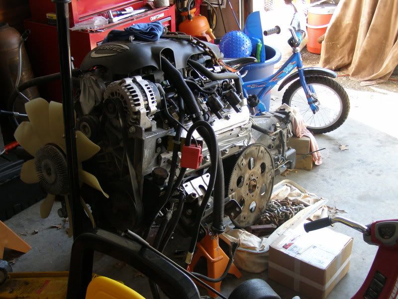

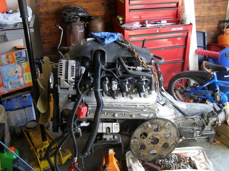

Here is a few shots of the 2003 5.3 Vortec that is going in my 1982 Scrambler. More to come soon.

I cant wait to get started. I have found the company that I am going to use to cut down the harness. Its www.lt1swap.com. I have decieded to ditch the drive by wire throttle and pick up a 99-02 throbble body with mechanical linkage. I was going to use M.O.R.E motor mounts, but they dont make them for the new vortec bolt patterns. So it looks like Novak for the mounts. I am still tossing around which tcase to use. keeping it all chevy and saving the $500 for a hunk of aluminum to adapt my dana 300, or biting the bullet and getting the adaptor and twin sticking the dana 300. I know what the consensus here will be. To keep the 300, or sell it cheap to one of you guys. I am pulling the 4.2 this weekend so I will make some progress on it soon.

i have the same project in the future,i will swap a 2003,6,0 Vortec in my CJ-7...will you ran with headers or oem exhaust manifolds? What for a trans will you bolt behind?

Make sure you get the gas pedel and tach module from the donor vehicle if is the drive by wire throttle. I am going to run a 4l60e tranny with my dana 300 transfer case. I will probably run camero manifolds, i've heard they hug the block quite a bit.

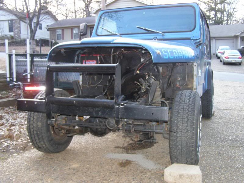

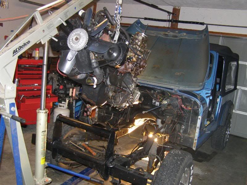

good advice. Thanks. I am using the Novak mm so once I get my forward to back location then I will adjust to the drivers side as close to the steering shaft as possible. Progress has been slow do to funds, planning and life. Here is a few shots of whats happened recently. Out with the old.
