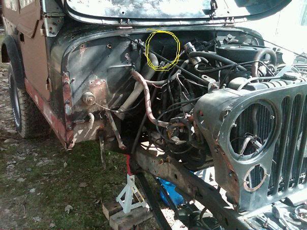

The transfer case vent is attached to the firewall near the valve cover.
Where does the rear one attach to? I had to put a new tube on it since the old one wasn't there when
I bought it, but I haven't put the rubber hose on yet.

It should run up the firewall near the battery box.
Where it attaches on the axle should be obvious. It runs up behind the passenger-side fenderwell, high enough to keep it from being submerged.

Here's the location on mine
