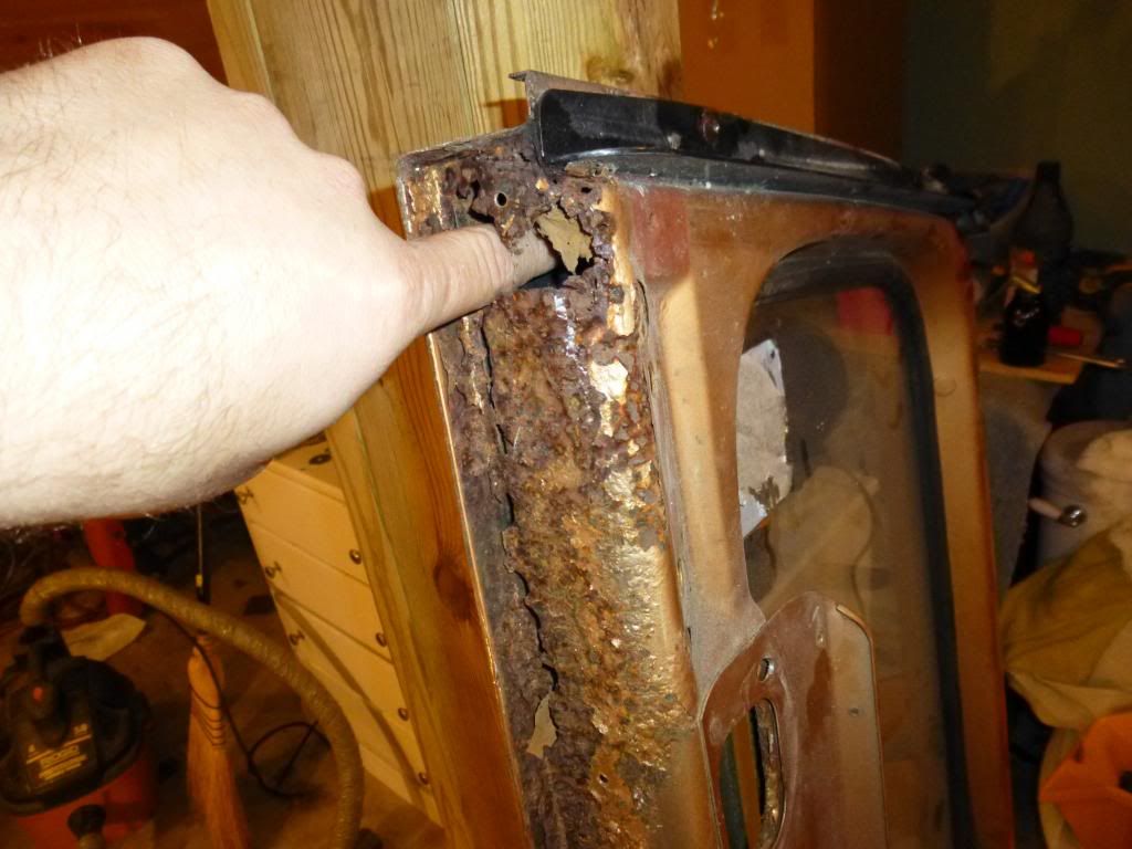

How bad does a windshield frame have to be before you junk it? Mine is pretty shot along the bottom, but the horror stories of replacements (and VERY LITTLE MONEY) makes me want to save what I got.

If there is enough metal to weld to once the rust is cut out then do it. Nothing on the bottom will be seen. The cowl seal will take up a lot of imperfection on the bottom and across the bottom lip (front face of the windshield frame). Do as good a job as possible with any area above the lip of the cowl seal. Does that make sense?
The down side... the frame will warp from the heat. Literally, we clamped ours to a big chunck of I beam, held a piece of wood at the correct spot, and beat the crap out of it with a BFH! We didn't know it had warped until we laid it flat on a table. It was worth it.
THAT being said, it will rust again, eventually. An aftermarket frame COULD be a better LONG-TERM investment.

Hey Buddy. I am definitely gonna weld in some patches. Did you see the pics in the other post? They weren't the worst I have seen, and like you said, the cowl seal will help, and nothing I do will last forever anyway!

You can bend 18 G metal to whatever form you need for the WS frame and weld it in. I used scrap on Clay's frame. I did not see the pic in the other thread, but I haven't been on regularly for a few days. Rock-N-Roll!

Wire wheel the rust off the WS frame so you can see everything a little clearer. Use a cutting wheel to remove the rusted out metal. Get some 18 gauge stock and cut/bend/mold it to the shape as closely as you can. Tack it in.
Once you cut out the bad stuff you will expose the bracing that's inside the frame. There will be spot welds that you will have to drill out if they haven't rusted out. Those spot welds are welded to the inner bracing. You will need to reattach the new metal to the bracing. Drill a small hole at the correct position and plug weld the new metal to the brace. Easy as pie!
Once everything is tacked in you need to slowly weld the seams, meaning waiting between welds so you don't create as much heat. Move around a lot. Keep it cool with ice in a rag. Try to reduce the warpage. Grind the welds down, but it's easy to grind too much. The metal is already thin, don't make it too thin! I am an expert about that!!! When you get it "done" coat it all with a layer of DuraGlas filler. This is a fiberglas filler that will seal it all up and keep the air off of it. No air, no rust! Or you will at least slow the rust down!
Remove the glass before welding!

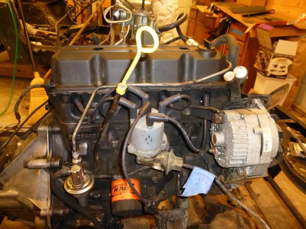

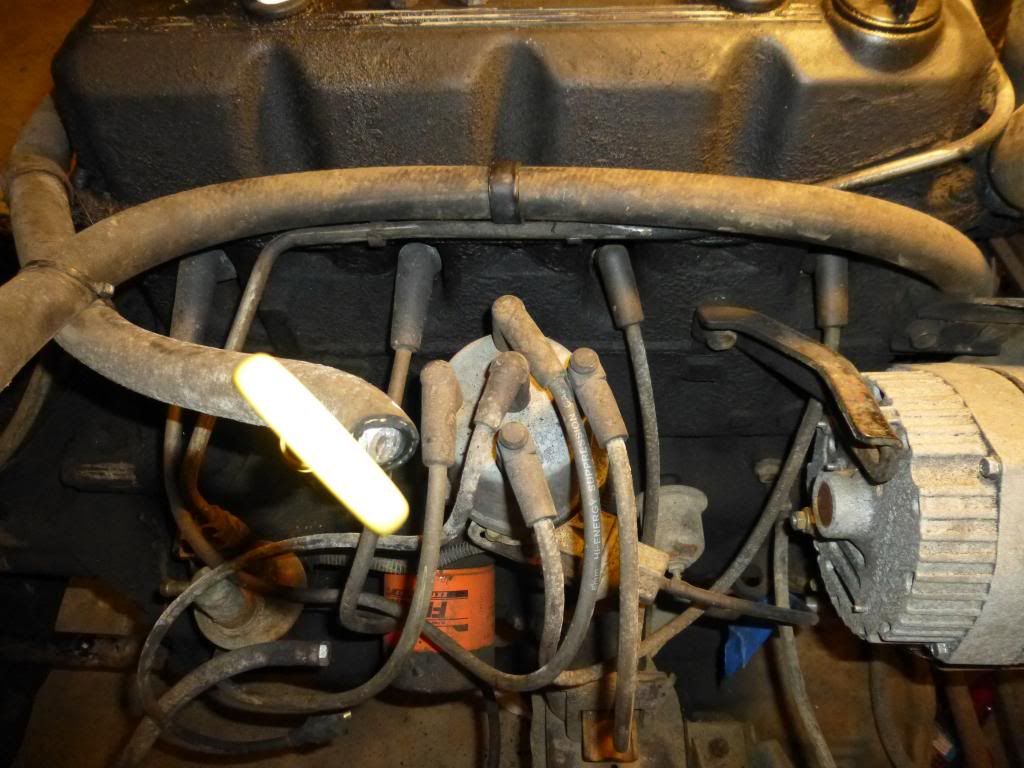

Windshield frame and some body stuff this weekend. I am trying to combat some serious Jeep ADD. I have every phase to work on- engine, chassis, fuel, body work, suspension, paint, parts, pyro...you know what I mean. If I dont watch it, some nights I just walk around the garage doing random things, half azzed, half way, losing things and breaking stuff.
Engine and chassis stuff this week and weekend, set tub back on next week and weekend, body work to follow (need garage for pregnant wifes car, so some body work will be done mounted- already did underside). All of my body panels and pieces are in various stages of work; ie. grill ready to mount, hood ready to paint, tub 30% done, fenders untouched.
Didn't get as far as I wanted last night (who does?).
Wanted to finish this stuff.
Didn't. Did get the lid off. I know nothing about what's going on here, but will learn when I build the 258 or V8 something in a year or two.

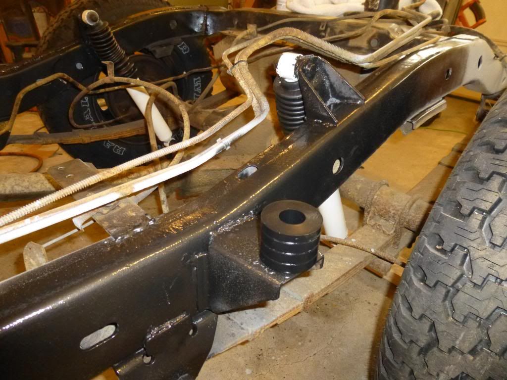

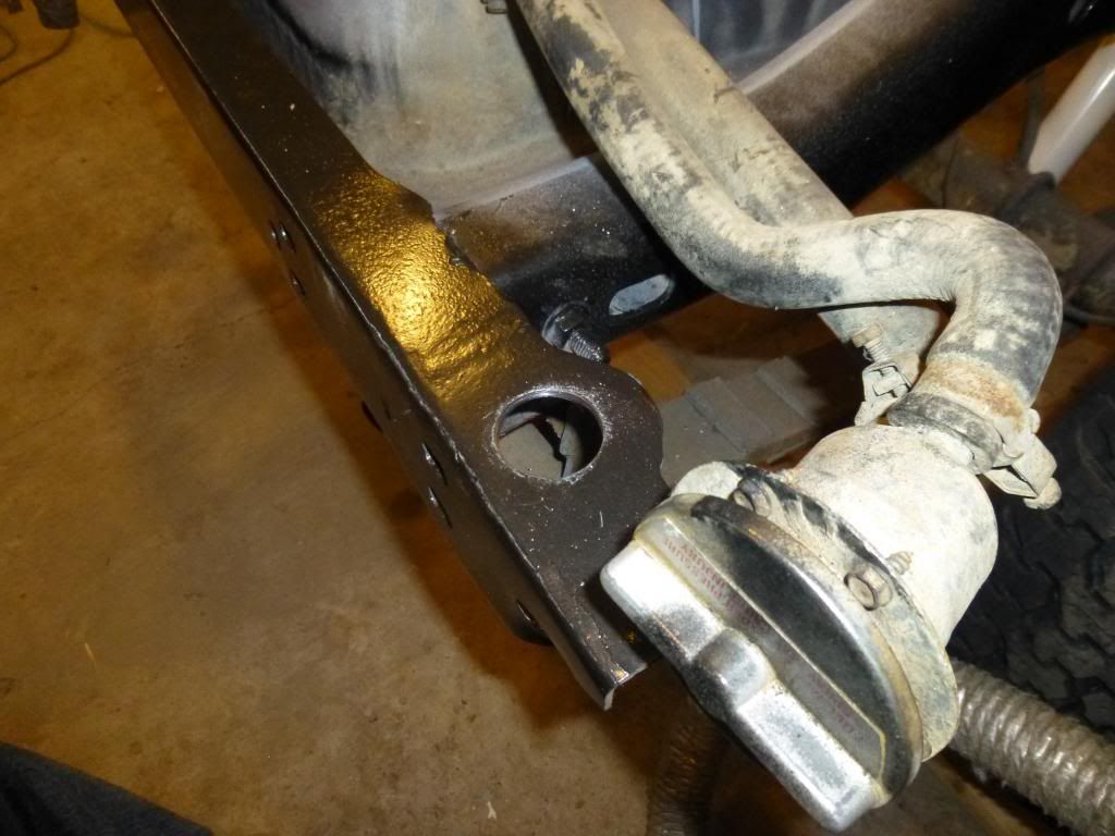

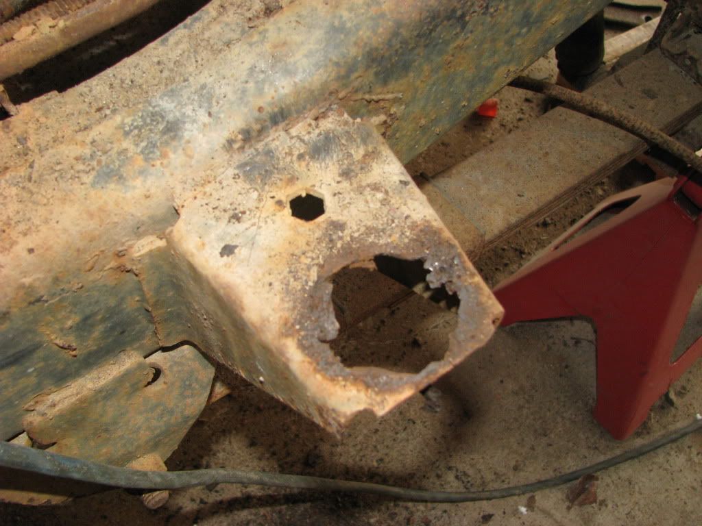

A while back I had to weld in new tops on two of the chassis' body mounts. I drilled the mounting holes during lunch today.
Pass side rear crossmember
Driver's side just in front of the rear wheel.

Good Job Boy! They don't have to be perfect... just PDC.
Remember the bumper sticker that old people would have on their car that said "One Day At A Time"? I understand that now!

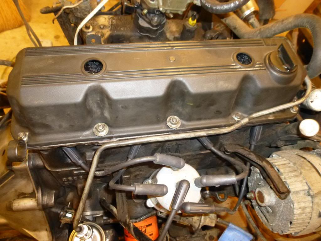

Cleaned and replaced valve cover. Holy cr@p did that take work! I hope I got a good seal. Somebody at FelPro should be smacked for the way they package that gasket.
Replaced plugs and wires while I was at it. Plugs were suprisingly clean.

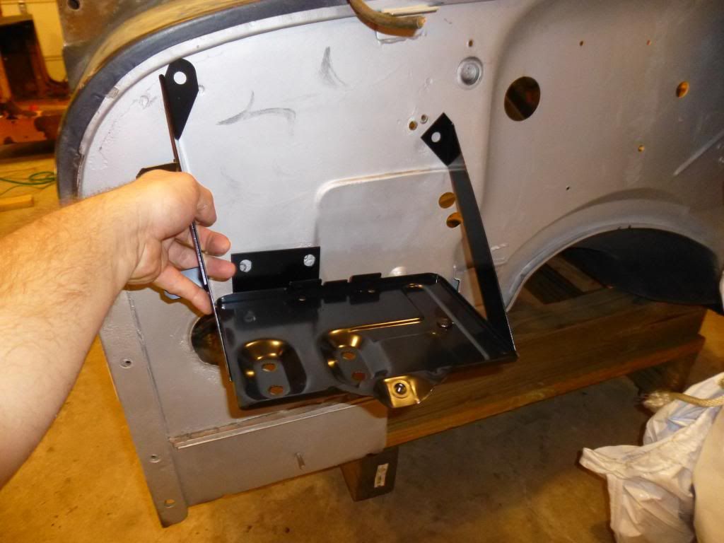

I also find your CJ ADD a little distracting. On this page alone, you've worked on the windshield, battery tray, ignition, valve cover and frame, but haven't completed any of them except the valve cover.
