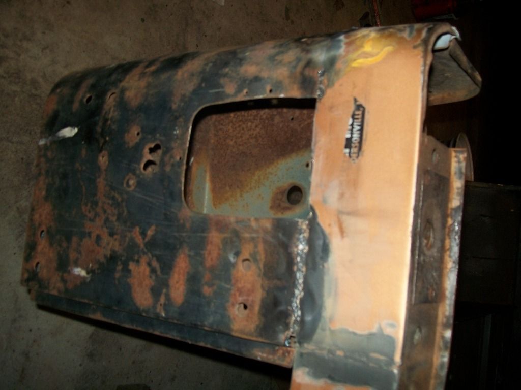

Got the floors in the front. The rest are good, so no need for my crappy welding there.
Other pieces in various stages of paint- mostly little stuff- grab handle, dash, grille, glovebox door...how the heck does one get that particular knob off?? I probably won't bother now, but it was the only one I couldn't get off.

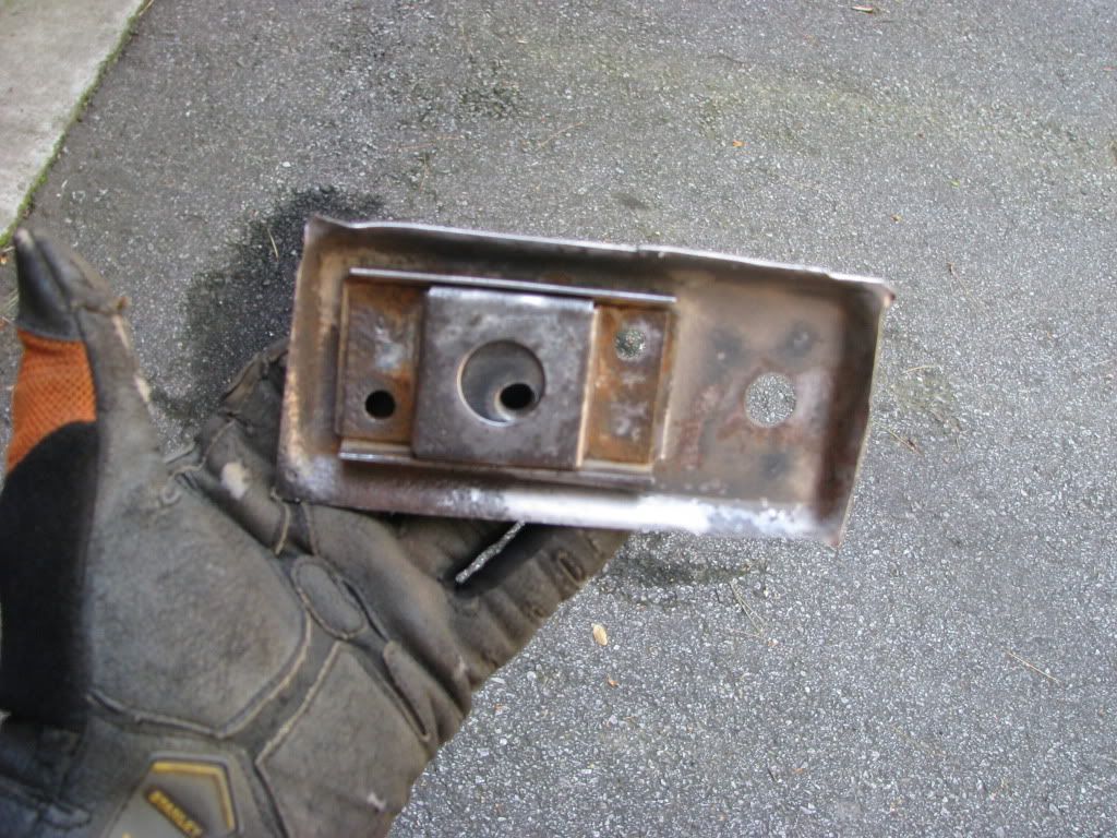

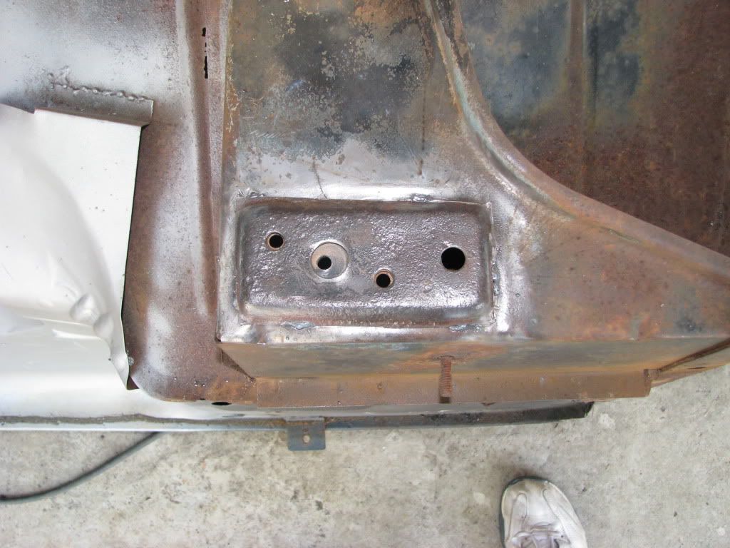

Some steel for the two shot body mounts- from TSC.
Got the rear body valance (mostly) welded on. The cinnamon piece is a little different in dimension from the blue one. We'll see how she fits later.
Cut it so the plastic tank filler thingie was incorporated. When its screwed on it covers the hole nicely. Some more bad welding, a ton of grinding and body filler, and bam! Good as new.
Sort of...

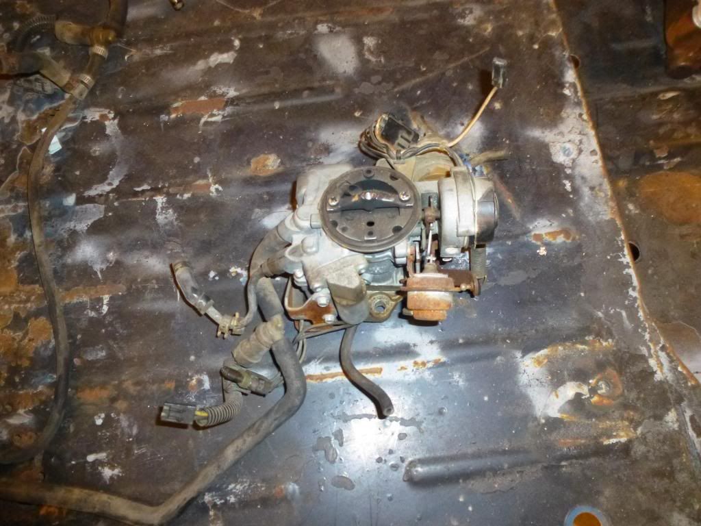

That said- I am slightly upgrading. I bought a Carter YF

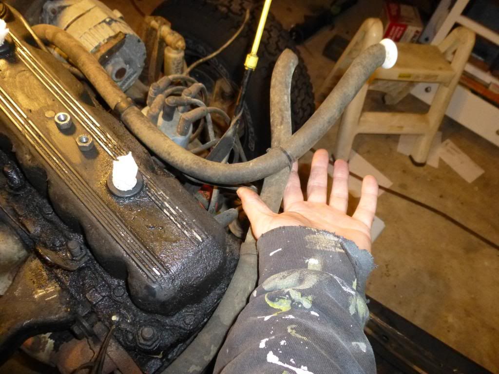

to replace this spidery mess, the YFA

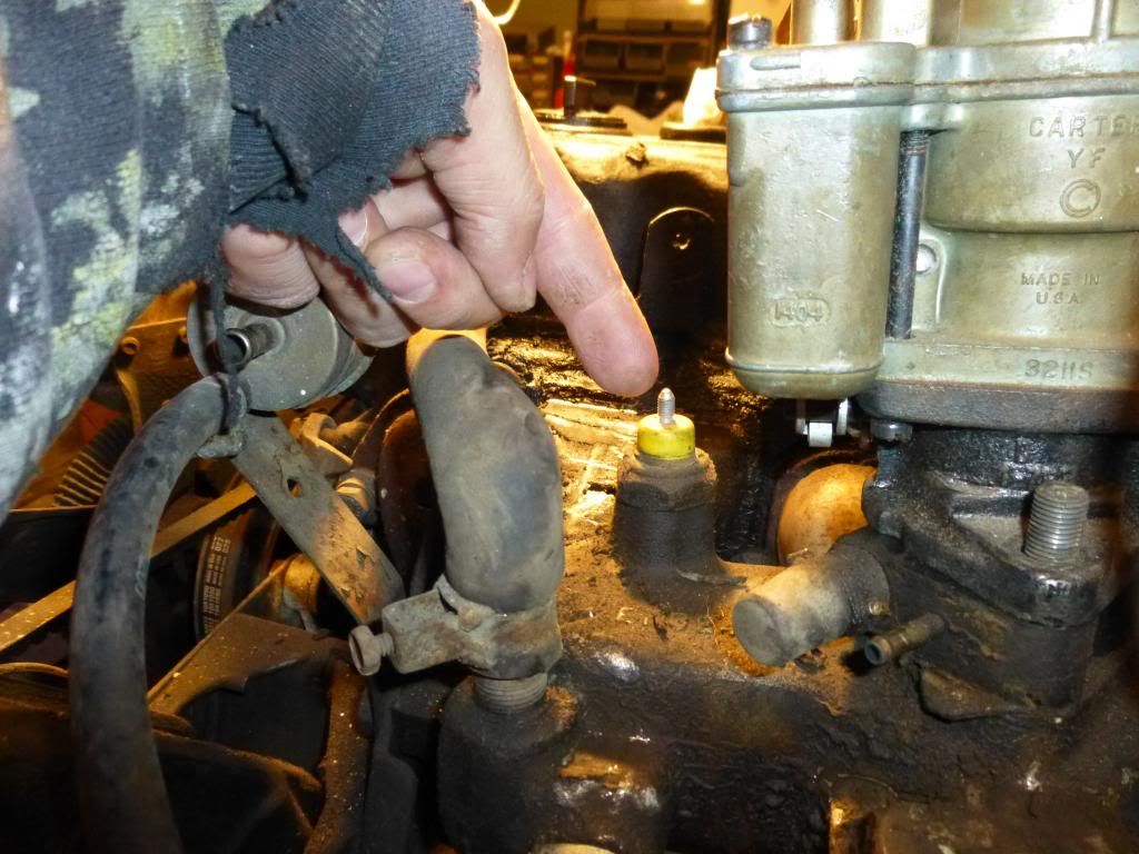

I am having a little trouble deciphering what can stay and what can go. Like:

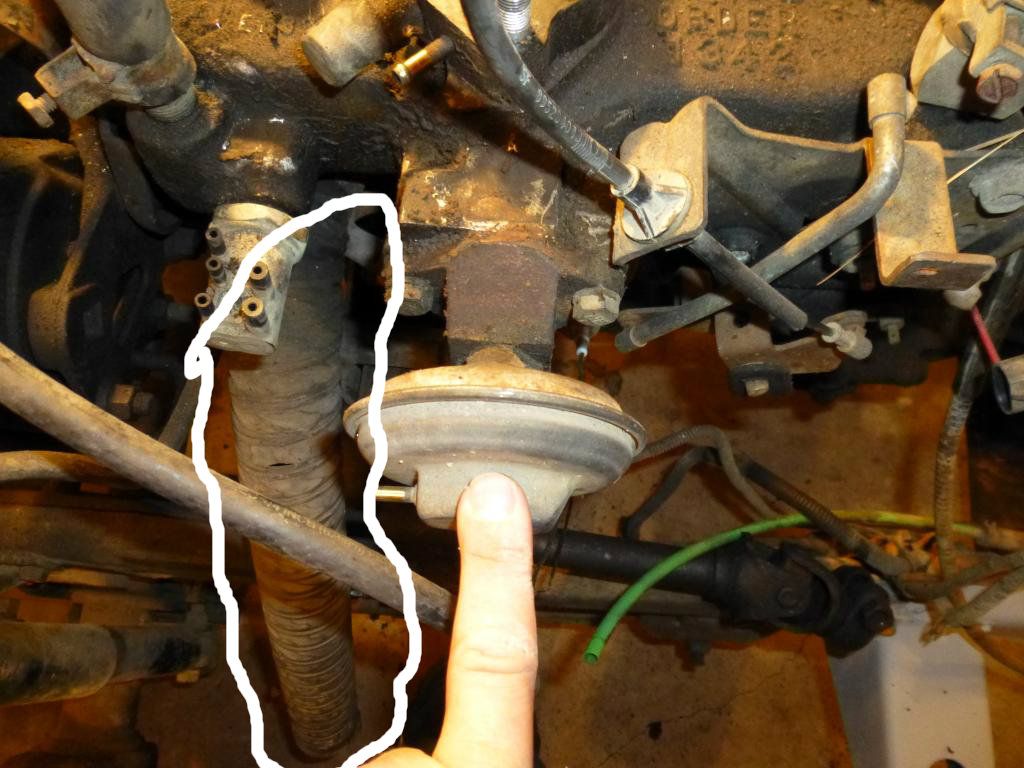

This thingie
or this widget

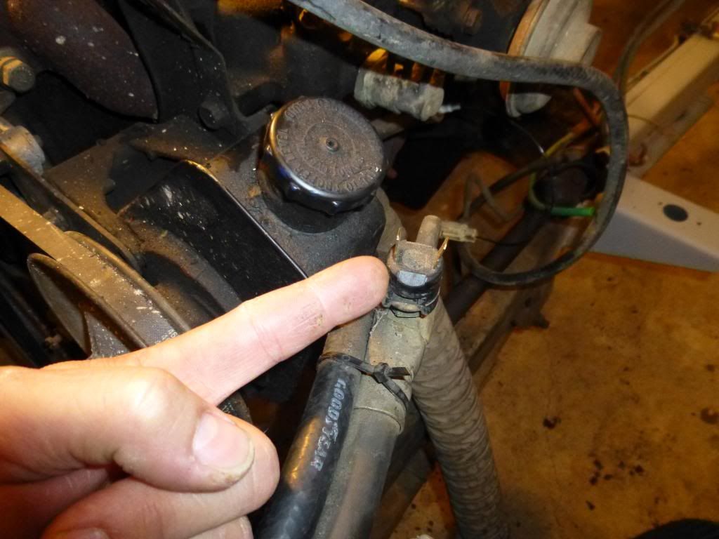

I think these go to the heater core
This doo-dad connects to the exhaust, do I need this?
This post is getting long- gonna break it up.

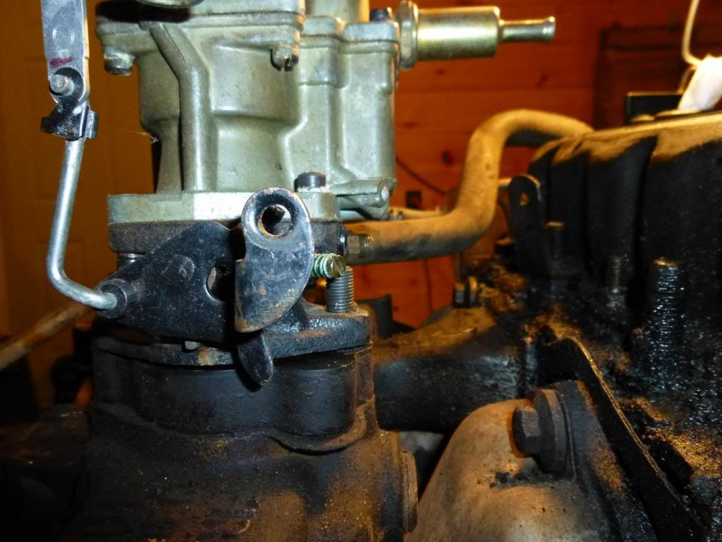

Already having a problem getting the YF on. Gonna ask a question about it before I break something.
The mounting bolt closer to the valve cover is hitting the carb body. Not to sound TOO stupid but, what the heck do I do with that?

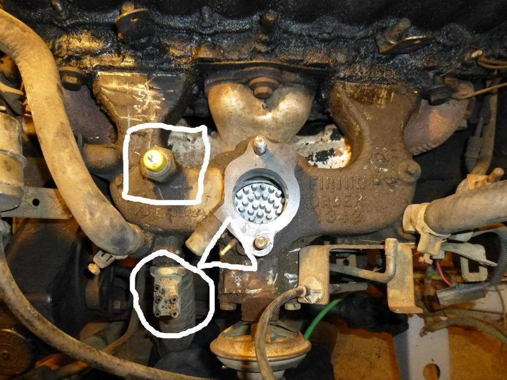

I am trying to figure out what is being circumvented by switching the carbs and bypassing the computer.
What is the sensor in the square?
Can I just cap off all the outlets in the manifold in the circle?
Same with the one in the triangle?

Originally Posted by WNC-84CJ7 View Post
Ok. Months later.....
Was gonna start a seperate thread, but I want to keep it together cuz I LOSE STUFF.
I am needing some engine help. Actually, I am in way over my head, so I am in need of serious help. I am doubting if this thing will ever run again. I spend almost as much time alternately cussing and weeping as I do wrenching.
I am NOT swapping motors right now, so bear with me. Just bought what the realtors call a "fixer-upper" and my gal is 5 months preg. My budget was tight before- its ZERO now- run what ya brung. The AMC 4 cyl stays.
This thingie
This is the EGR valve. Some people say it keeps our polar ice caps from melting, but without a computer you won't need it. It can be capped off.
or this widget
I have virtually no idea what that thing is! If it pertains to a smog system, you won't need it either without the computer.
I think you're right... (yay- you got one!)
I don't know what that is either, but without a computer....
Either add a spacer to raise the carb, or remove the stud and install a shorter one. OR- install a holley 650 double-pumper! Think of the cool factor!
It is a sensor. Without the computer you won't need it.
You can remove the whole thing and install a pipe plug. You did say you were bypassing your computer??
Definitely cap that if it isn't going to be used. That will be a big vacuum leak.
And...
This tubey guy went to the air cleaner contraption that was on the bracket and the YFA. Since doing away with said bracket and YFA, the cleaner will now sit on top of the YF. Where to with tubey guy?
That could be reconnected if it is not too short. It helps preheat... something!
I am going to the store for some engine de-greasing stuff. Gonna do it this afternoon- even though it is 20 degrees outside. Any suggestions on products or methods?
I especially like Castrol Super Clean, because it does. Next, I like Purple Power because it... is purple. Not really, it cleans almost as well as the Castrol.
I hope I am not more damging than informative, Chris. If you Nutter the engine, most of that stuff goes away. Although I can't say specifically what everything does do, if it is emissions- related you won't need it. I can't offer anything for the Carter or the 4 cylinder. Wish I could.
Congrats on the fixer-upper. I was there 11 years ago, and I turned it into a mansion! And preggo!? C'mon! Ya'll need to stop drinking the mountain water!
Blessings Bro.
PM sent to ya.

Thanks Scott! That wierd plug looking thing was on the hoses to the steering box. I am probably just going to do my darndest, hope for the best, give it a couple shots here if it doesn't run, and take it to my auto mech if I can't get it to go. Actually, it's not the engine that scares me- it's all the ancillary stuff under the dash and the stupid looking harnesses I have hanging in the garage. I have parts that I look at and think "uh-oh".

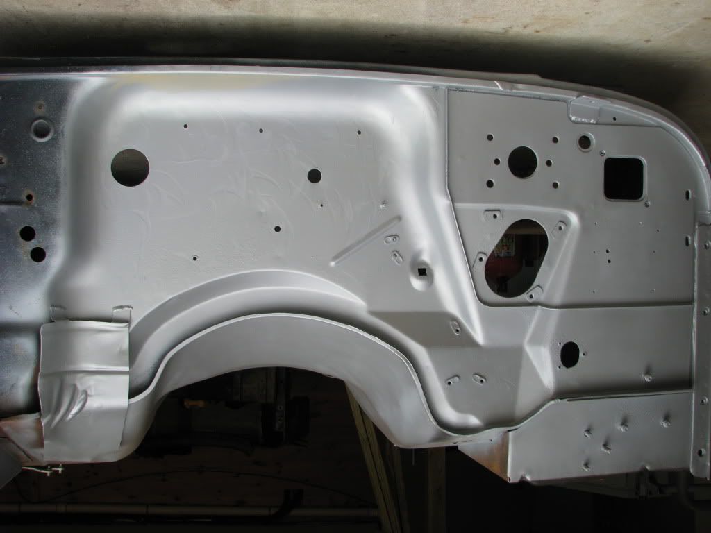

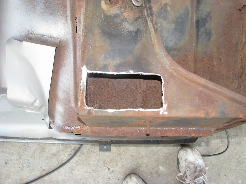

Gonna pop up some old pics cause of broken links. If you see something awry let me know. And don't say the engine...I know.
Firewall
These came out good
This side was shot- hope this works.
What's this??
