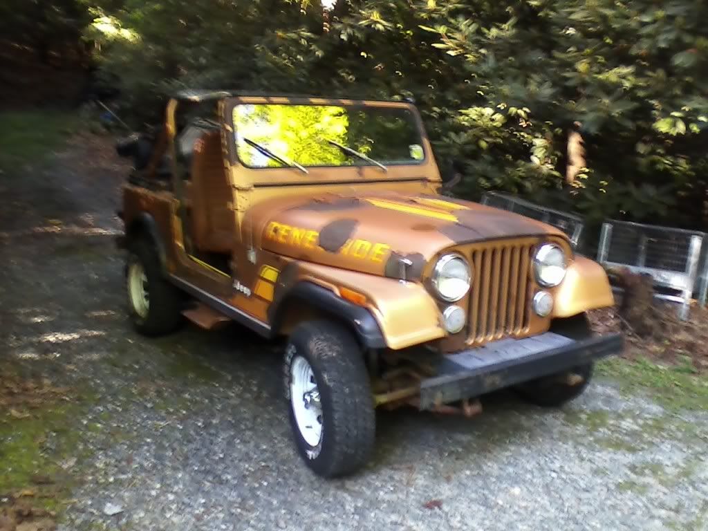

Before the butchery
From my phone, at the PO's house

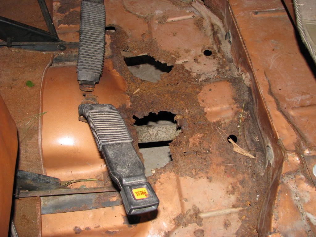

The "floor"
