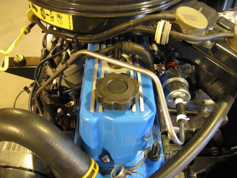

I got lucky and found an aluminum cover that uses the original 2 mounting bolts on the top of the cover. No need to drill or tap additional holes, and I don't have to mess with difficult to reach bolts.
I used a heavy bead of the Right Stuff gasket maker, and tightened the bolts with my fingers just enough to mush the bead a little.
I've put approximately 5K on the engine since and no signs of a leak, so far.

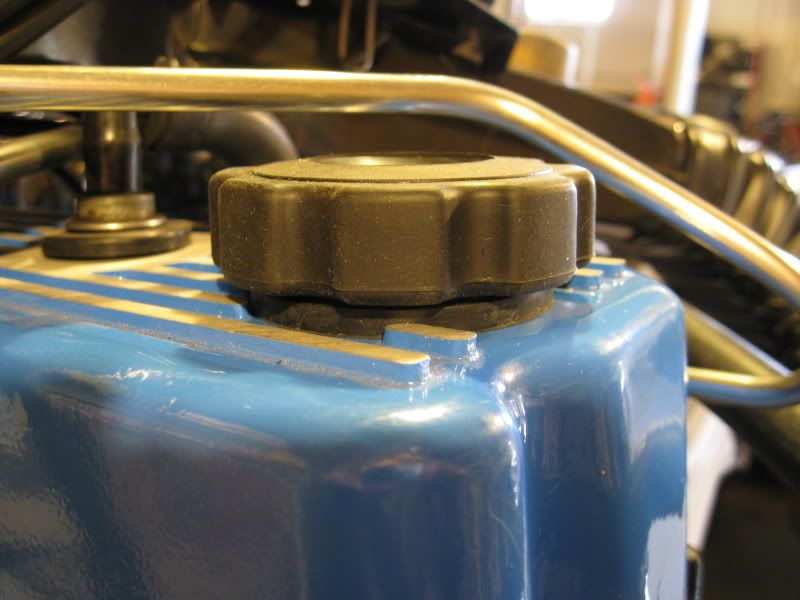

Even though I have an aluminum valve cover on my engine already, I really like the looks and design of the one above that Matt1881CJ7 has.
Where did you get that one? Who makes it?

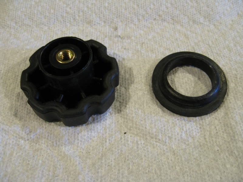

I see you have a bolt through the oil fill cap because I know they are prone to leak. I found several ways to stop the fill cap from leaking and after experimenting with a few replacement plugs, I use one that stays in place and no leaks.
Got the cap from McMaster-Carr and the seal below it from Ace Hardware. It just pushes down and seals on top of the cover. Takes a little bit of force to get it off though but, I'd rather have it tight then loose.
Did you use any sealant on your cork gasket? It looks like you didn't.

The only thing I used was CRC Copper Coat Sealant Compound. Applied it to one side of the cork gasket and let it dry to a tacky feel I also applied the same sealant to the surface of the cylinder head until tacky and then bolted the valve cover, with gasket in place, onto the head.
Never leaked once, even after having the valve cover bolts loosen up on me. Took them out and applied 'blue' non-hardening Loctite to the bolts, followed by a internal star lock washer. Torqued them to spec and have not had a problem.
