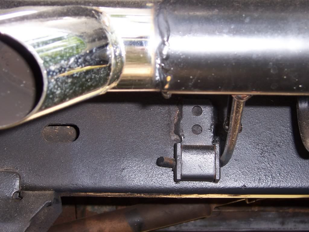

Here's my setup. I love the easy access, and it is a cheaper way to go. As i've said before, it's louder than a stock Harley but quieter than a Harley with straight pipes.I can post pics of the mounting if you're interested

I would like to see how you have that mounted.

Tetanus,
I wasn't sure if you were asking me or BLS33, but here's how mine is mounted.
