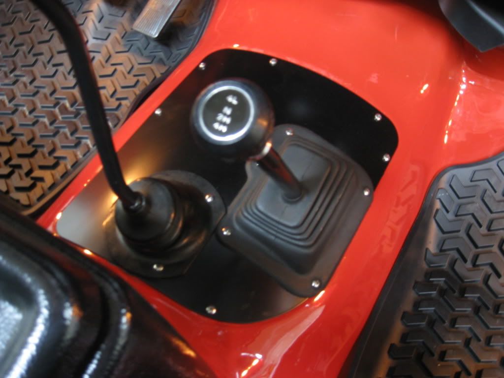

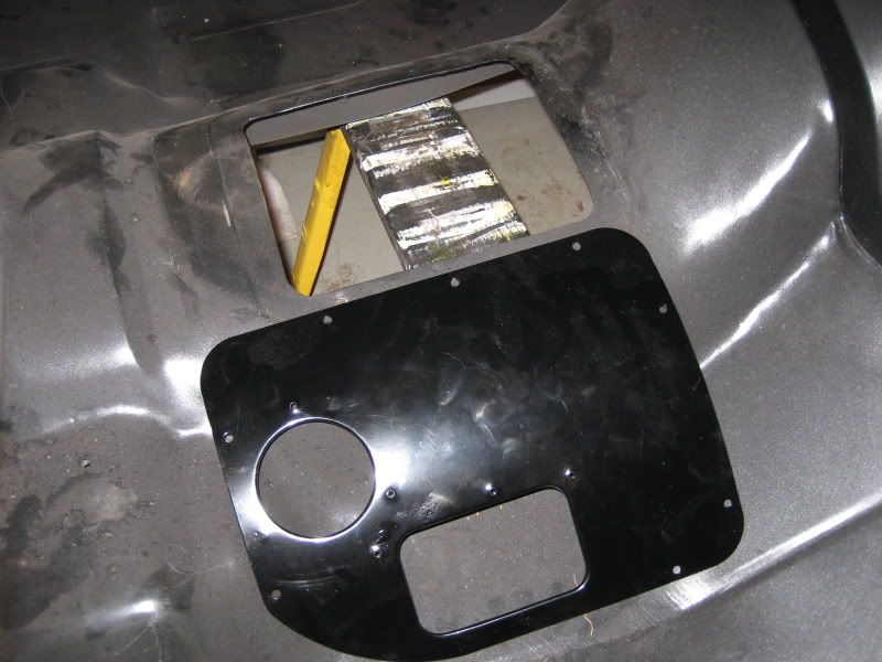

I see you got a floor pan from the MD Juan Company in the Philippines. Same one used on my Repli-tub with the same incorrect trans hatch and various other annoyances like no seat belt anchoring plates, drain holes, etc. I had to cut the hole larger for the trans hatch opening and hand crimp a offset flanged edge to match the later transmission cover plates. I actually decide to make the cover plate and opening an inch wider so the TC boot would not need to screwed into the floor pan.
Hi Keith. We're not using it. It's old stock I reckon and as such is flawed (excuse the pun). It would just be too much work. I got one for my red 8 and I won't use one there either. Sorry Rommel.
