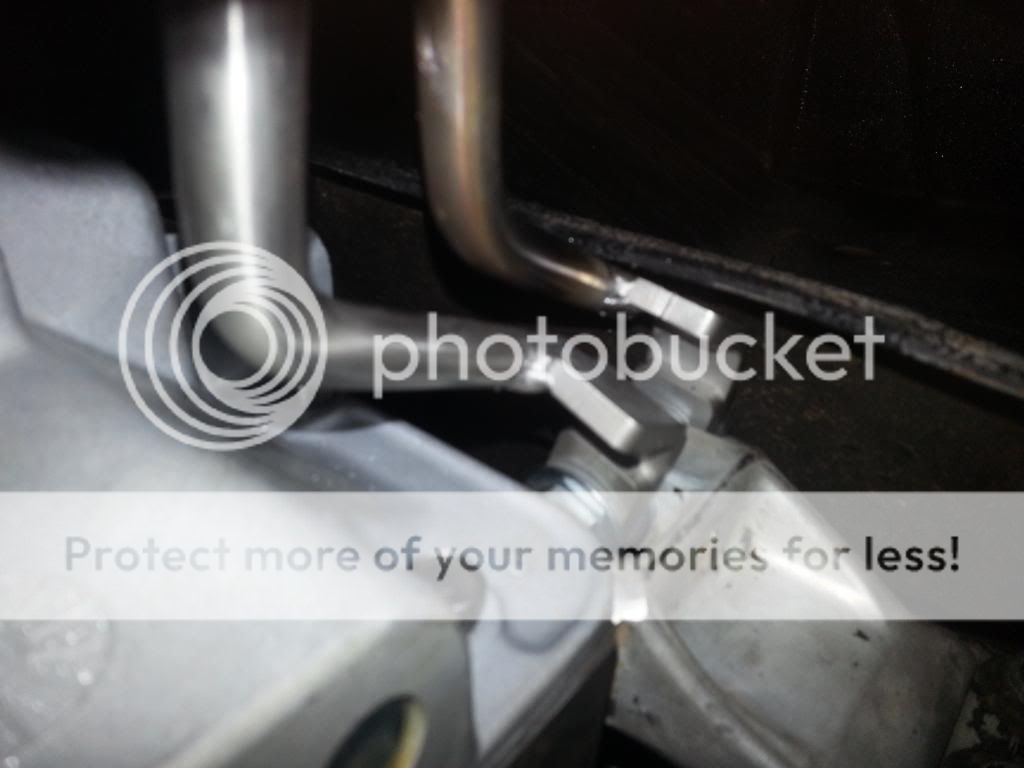

I did mine on the bench, but it could be done from underneath depending on were your exhaust is run. I wouldn't be able to do it on mine as I have exhaust on both sides of the transfer case.
I also had to heat the shifter rods and bend them to make them clear my tunnel opening as I didn't want to cut the floor any.

One more question, on the existing shifter the big bolt that holds the shifter to the transfer case. Does it slide out? There does not seem to be much clearance on the non bolt side. What keeps it in?

It's threaded into the aluminum tabs that the shifter fits into. Unthread it and then it slides out.
