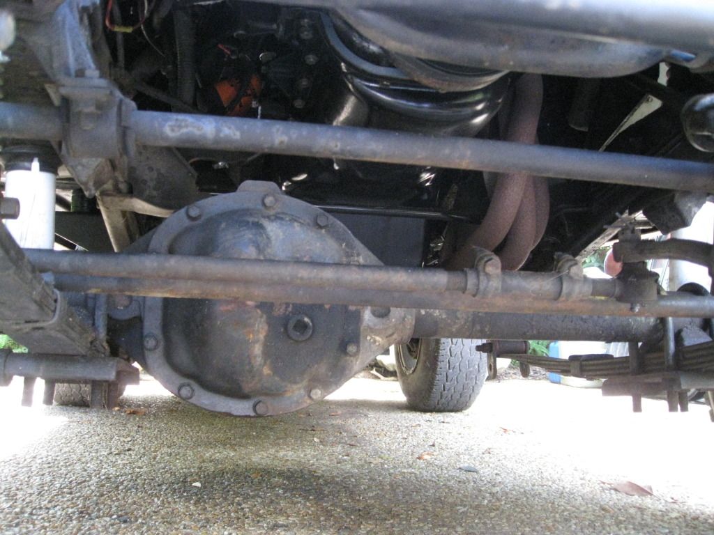

You might ask why we didnt go ahead with the OME leafs? After all, we had the old ones partially disconnected. Heres the predicament I am in at the moment.
Since time and money are both factors, I decided to look for some axles already geared the way I wanted. I found some axles with 4.10 gearing. We agreed on a price that the seller suggested. Then when the time came for me to get them, he made excuses for not being available and then would not respond. I found out recently that he is still trying to sell the whole lot of disassembled parts he has as a whole. Since I can't find any axles, I can't run 33's. If I can't run 33's, I don't need the 2.5" OME leafs yet. Hence have taken a bit of a detour from the original plan with the suspension.
After getting rid of the PO's hack job on the rear crossmember, giant rear shackles and lack of rear body bushings, we took it for a drive. Although the ride was slightly improved and obviously safer, it was still quite rough. We decided new shocks were in order. Found some that were budget friendly on rockauto.com.
After install we were pleasantly surprised at what a difference they made in the ride.
Here is how it sits. A little higher in the front at least. Not exactly sure of how everything ended up until I take another measurement.

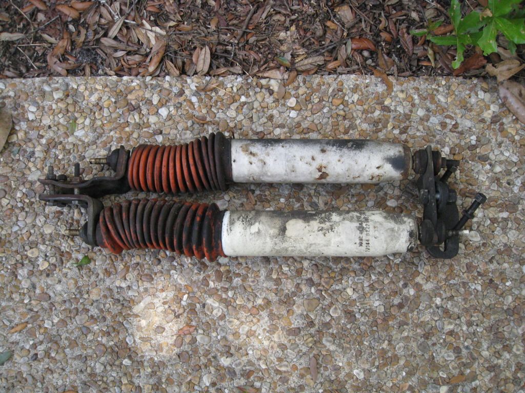

The next thing we want to tackle is the steering. When driving, it seems to have a slight delay when turning the wheel one way or another. It has a 1 inch body lift and YJ rear shackles but I am not sure about the leafs. As mentioned earlier, when I got the Jeep it had Rancho shocks but I could not find any marking on the leafs. I am pretty sure they are stock.
What I am getting at is I don't know if the reason for my steering issues is the caster problem I have read about when a CJ has a suspension lift. I'm sure the tie rod end could use replacing, but I just greased them for the moment. I also made sure the steering box bracket was tight.
I am begining to wonder if these may be a factor in the steering delay? What do you guys think???
If these are like the shocks were then they are shot. Could they cause something like I described? Would I better off without them?

Will definitely be getting around to all the front end bushings soon. I might just remove the front stabilizer shocks this weekend and see if it helps. Any opinions on this?

Couldn't hurt, your drag link is flat enough you shouldn't have any bump steer anyways.

Just putting new bushings up front will make a huge difference in the handling. You surely don't need dual stabilizers.

Just catching up, great progress! I would ditch the duel stabilizers as well, will make it easier to hunt down the problem.
The stabilizers are just a band aide that covers up the problem. I run 36's swamper tsl sx's, 4.5 " spring lift, 1 " body lift, 4 inch drop pitman arm, big daddy tie rod and drag link flipped and can 1 finger at 55 with no stabilizer. All my bushings have been replaced, shocks, my perches moved to fix caster. No bump steer, no wander. Drives better now than when I got it all stock with 31's.

Thanks MoC! I hope to get mine to perform like yours. I removed the dual stabilizer setup this morning.
It looks a lot less cluttered/junky now.
I checked the front shackles for any movement while turning the wheel and they checked out good. Then I made sure all the tie rod ends were greased and took it for a spin. Steering seems to have improved although some delay is still there and the steering wheel does not return to center. This is my first jeep so I am not sure what is considered normal. Maybe some steering delay is to be expected, but should I be having the "not returning to center" issue with basically no suspension lift???
