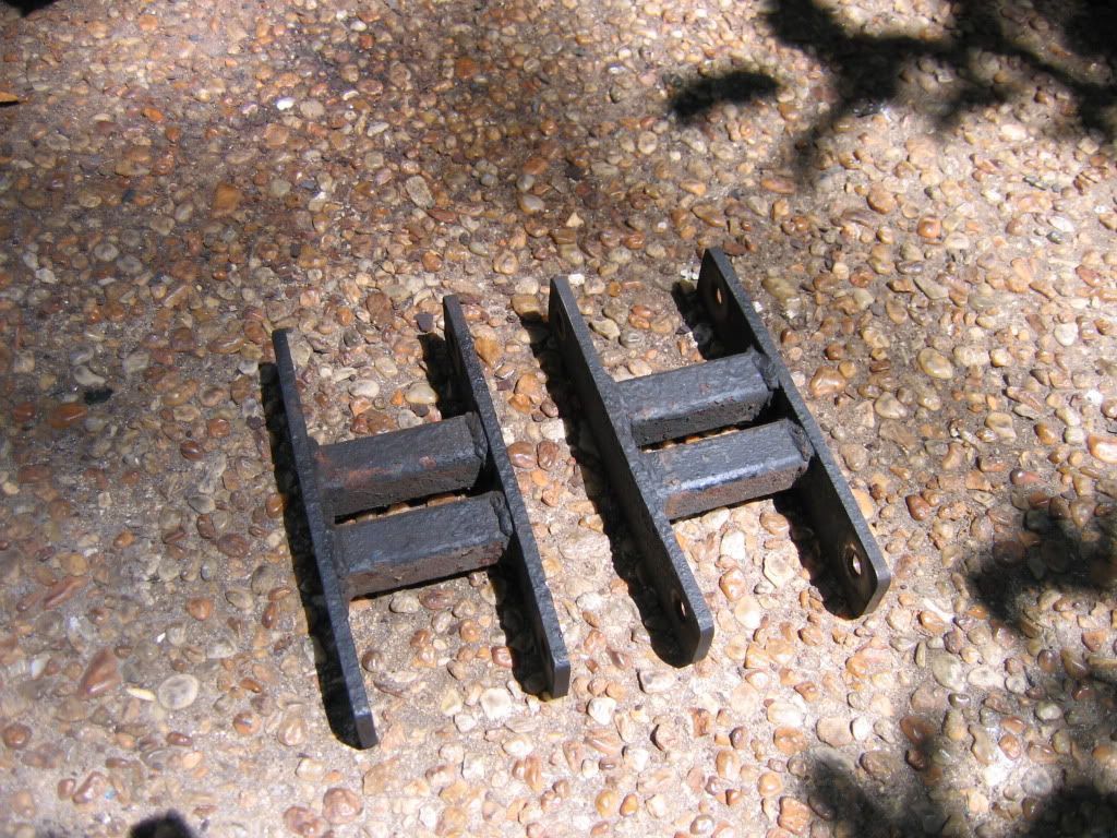

Removed the monster rear shackles. These things were 6.5" bolt to bolt and the bushings were pretty worn.
