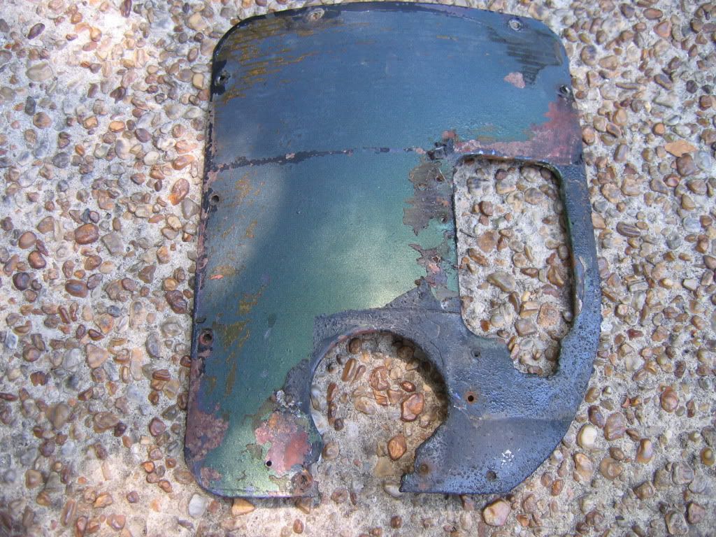

Next was installing the tunnel cover, shifter boots and knobs. The original cover was removed when we did the clutch, trans and transfer case. By the looks of the hack job on the shifter cut outs, I am assuming the Jeep had a body lift at one time. It looked like this after removal.
I had to peel off what seems to be some kind of adhesive bedliner type stuff before I could pry off the cover. Has anyone seen this stuff before??? It covers the floor completely. Not looking forward to peeling that off, but will be necessary for when I get to the rust repairs.
Found a used cover, refinished and reinstalled it with new trans boot. Cleaned up the original trans shifter knob and D300 boot since it was in good shape with no tears.
