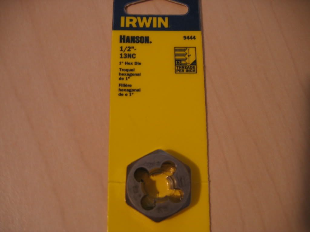

Unfortunately i don't have a welder yet. So, I was able to find a die by Irwin/Hanson.
I am hoping it is of better quality than the autozone or HF ones which didn't have very good reviews.

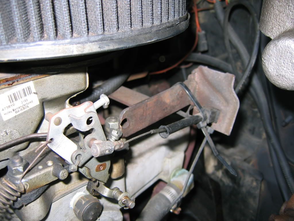

UPDATE: After getting all the pieces together, I decided to dry fit the YJ booster, master and bracket. It almost dropped right in until the bracket that holds the throttle cable got in the way.
The top part of it interferes with the booster and appears to be fabricated by a previous owner. I did a little research but havent found anything definitive as to a certain bracket to use. I also dont have a welder to try to make something different. If someone has some good info on where or what kind of bracket I can get, please let me know.
Our main objective has been to get it on the road so Dad and I can enjoy it a little before really tearing down for a full restore. So we decided to just replace the MC for now and do the upgrade later. So we bench bled the MC, put it in and bled the rest of the system. WE NOW HAVE BRAKES! This also enabled me to clean up the firewall a bit.

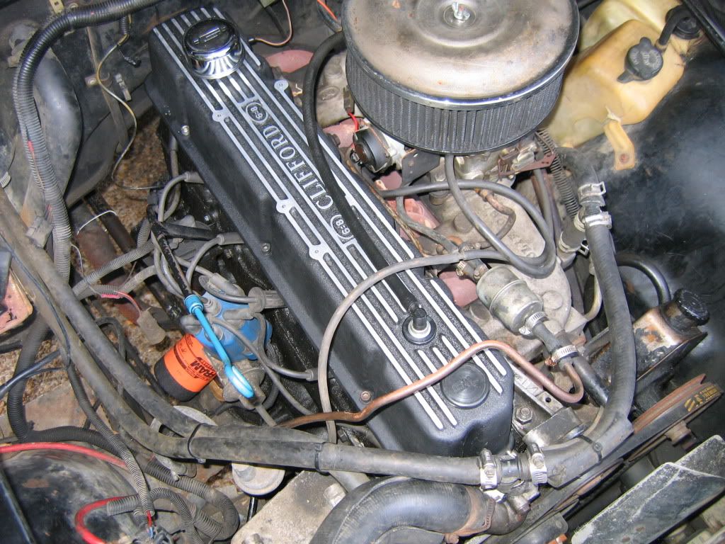

Here it is. Far from done , but eager to stretch its legs a bit.

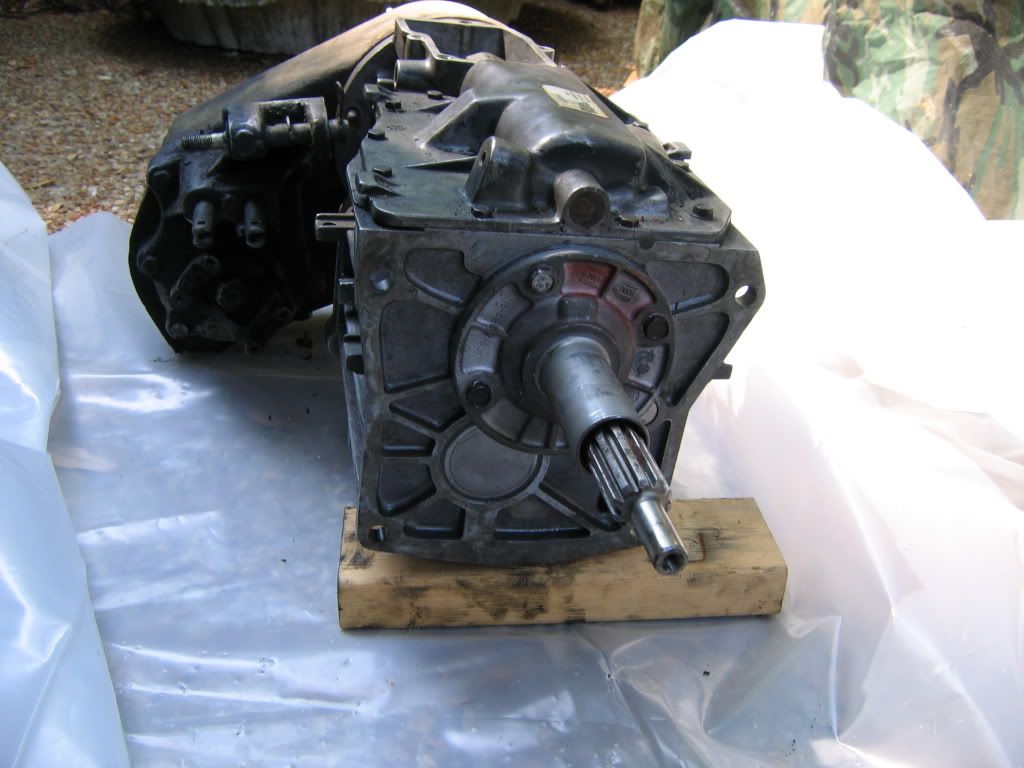

Pulled trans/transfer-Do I need a new clutch?
Tried different fluid but got the same results. Looks like 1st gear is toast, so we decided to swap out the transmission for freshened up one for $250 plus my trans as a core. Gonna take a look at the clutch while I'm in there.

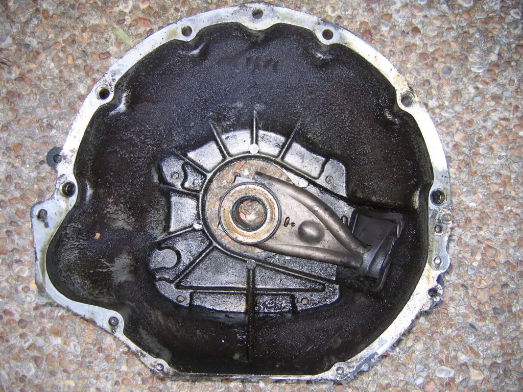

Removed the skid, shifters and tunnel cover and supported the engine underneath the oil pan with a jack stand. Then tried to remove the transfer case but couldn't get it to separate form the trans. Since I didn't have a transmission jack, we used a regular jack underneath. For added safety and support, we looped a ratchet strap under the trans and through the hole in the tunnel, hooking each end to the seat frames on either side. Sorry no pics of this since we were trying to move quickly and not stress the motor mounts any more than necessary. With one person operating the jack underneath and the other in the Jeep pulling up and back on the ratchet strap, we were able to support and back the trans out with the transfer case still connected.
Turns out there was one bolt still holding the two together. I didn't see it since it was in the recessed area near the shift rods. After removing it, they were easy to separate as there was only rtv used in between the two cases.
Removed the starter, clutch linkage and bellhousing.
It had so much oil/grease all over it that you would think it was black. Next was the clutch pressure plate/friction disk which turned out to be made by Luk. I'm not an expert on clutches, but they seem to be in pretty good shape from what I can tell. What do you guys think???

May be a little late to comment but I'd say you should have the flywheel resurfaced and go ahead with a new clutch and pressure plate. The time to do it is when you've got it apart anyway. Kinda late posting though and you may already haver it back together.

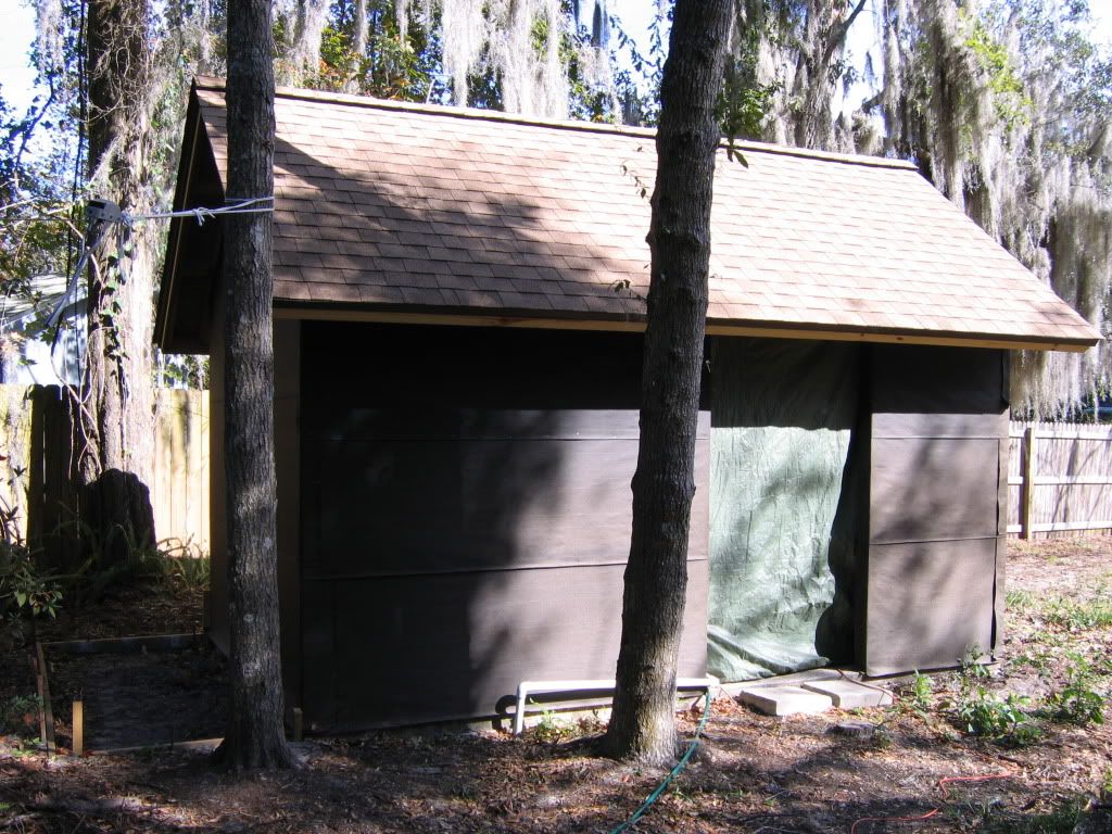

Well the project got delayed for a while since my dad and I have been working on a pump house/utility shed. The idea was to get the shed done which would serve as storage for the stuff filling the garage right now so we could get the CJ in the garage to work on. This is the current state of the shed. We started with just a 10x16 concrete pad.
To finish it up we have to pour a slab outside of it (for the aerator and extra storage)and reconfigure the pumps and plumbing so they fit in one corner inside and then of course siding. Lately life has gotten in the way so my dad and I haven't been able to coordinate our schedules very much, so I've been gathering parts and he has been helping me do things bit by bit.
