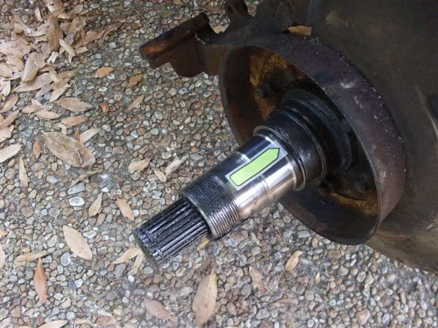

Originally Posted by Coiz View Post
Nice find. Is that a mystic paint changing between blue and green? Also looks like you have a shackle reversal on the front end. Your rear shackles are also longer than stock. Stock shackles are 3" hole to hole so if you measure yours, the amount of lift is half the difference in additional length. So if your shackles are 5" hole to hole, they are 2" longer but that equates to 1" worth of additional lift.
For the camber problem, the destroyed bearing is a nice find. Out of all the things that can cause camber issues, a bad bearing is probably the easiest fix. To get the hub and rotor the rest of the way off, remove the outer bearing(sounds like it fell out in pieces), reinstall a single large washer and thread on a nut. Grab a hold of the rotor and pull it toward you. Sometime you have to give it a good jerk for it to pop off. You're basically dislodging the rear seal in the hub to get the entire hub/rotor assembly to come off.
If I misunderstood and you already have the hub removed and you have bearing metal embedded into the spindle metal, we really need to see pictures of how bad it is. Not sure if something like that can be repaired or if it will require a new spindle.
Thanks for that info about the lift. Will have to measure later to see. My dad just got this pic for me, of the spindle/bearing piece. The arrow points to what I believe is part of the bearing still on there.

That is the inner race for the inside bearing. They should only be a light interference fit. You should be able to pull that off. Try a puller or a couple screw drivers prying at the same time. If worst comes to worst, cut across the face in a couple places with a die grinder and break it into two pieces.

Had to resort to the dremel method, but its off now. Does the spindle look too scored to reuse? I definitely need to replace the hub as there are pretty big gouges in it where the bearing that came apart was riding. Anyone know if I can get a hub local?
Turtle71 is offline   Reply With Quote Quick reply to this message
Unread 03-15-2011, 04:02 PM   #22
Coiz
1979 CJ7
Location: Northern, IL
Posts: 4,217
I'd probably clean it up and reuse it as long as the new bearing race fits like it is supposed to. Can't help you about finding a hub locally but it sounds like you are looking for #26 on this page, make sure you get the correct 5 or 6 bolt hub depending on your locking hub design. Promo code forum9 gives you 10% off if you end up ordering it through Morris4x4.

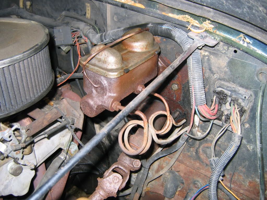

Another thing I am contemplating is whether or not to go ahead and install the single diaphragm booster I pulled out of a 93 YJ.
Installing the booster itself doesnt seem too difficult, but I am unsure if I should use the old or new proportioning valve. From what I have found, some use the old and some use the new. Another shot:
I know its not a dual diaphragm, but figure it will still be a decent improvement over my current manual setup.
If anyone has suggestions, feel free to chime in.

Unread 04-27-2011, 08:18 AM   #26
LSUtiger
1980 CJ5
Location: Shreveport, La.
Posts: 1,133
The single yj booster is fine. That's what i have. As for the prop valve, I used the old because it was a lot less work. Just take the lines off the old mc and bend them to the other side and bolt the new one in. No new lines to run. I also couldn't get the old prop valve off without damaging the lines to it.
Good to know. I thought I might run into some difficulties removing the old prop valve and replacing with the new. I'll probably just use the old one unless some one has info about the new one being a significant improvement. Picked up a coupler today to extend the push rod. Just need to find a die to thread the rod.

Unread 04-28-2011, 01:22 PM   #30
Turtle71
1983 CJ7
Location: Jacksonville, Florida
Posts: 589
I've got family up in Nashville. I checked out your thread a few weeks ago. Your CJ looks nice! Wish I had some of your fab/welding skills.
Trying to get some things together to be able to put the booster in. I need to find a die that will be able to cut threads on the rod so I can extend it using a coupler. Also thought a small tubing bender would come in handy to get the existing hardline to the other side of the booster. I may end up bleeding it as is with the manual setup just so I can drive it a little while I am getting the booster ready. Does anyone know if the dies at Harbor Freight will be able to cut threads on steel?
